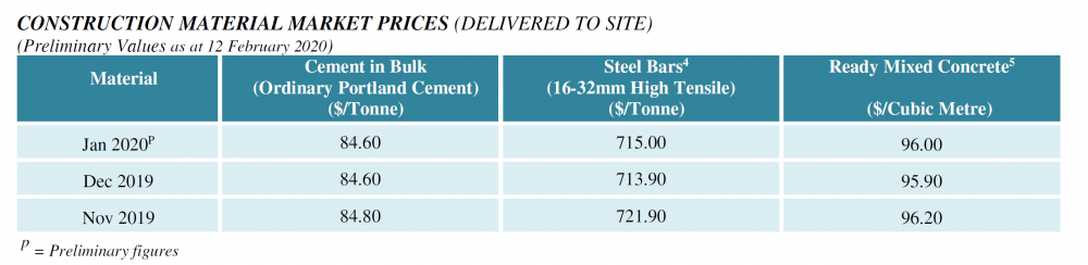

below is the tender price index from BCA which basically shows that there is a 20 percent increase in 4th quarter 2021 prices against prices in 2019/2020.
see the below tables on how raw material prices has increased from 2020 till today. Cement price has increased by about 20 percent, concrete price by about 10 percent and steel rebars pricing by almost 70 percent.
If you look at the text in red, BCA is expecting further higher raw material prices due to the fact that we are importing in all the raw materials and oil prices (needed for transport) has increased due to the war
