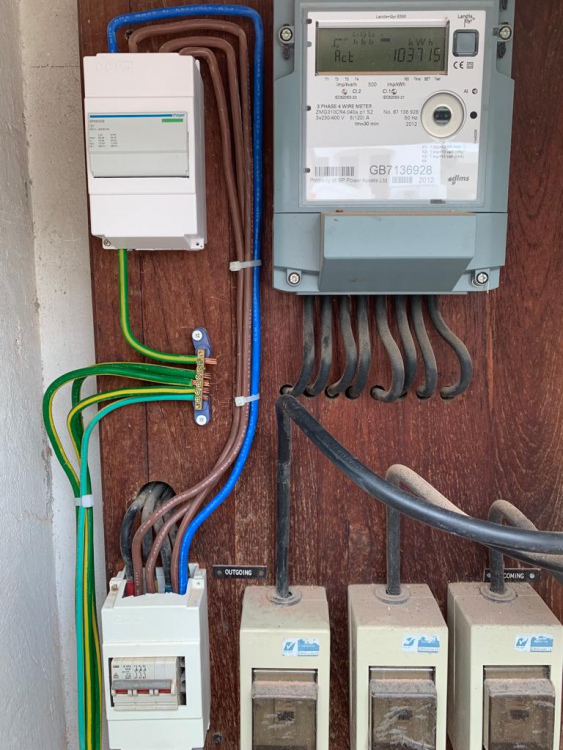

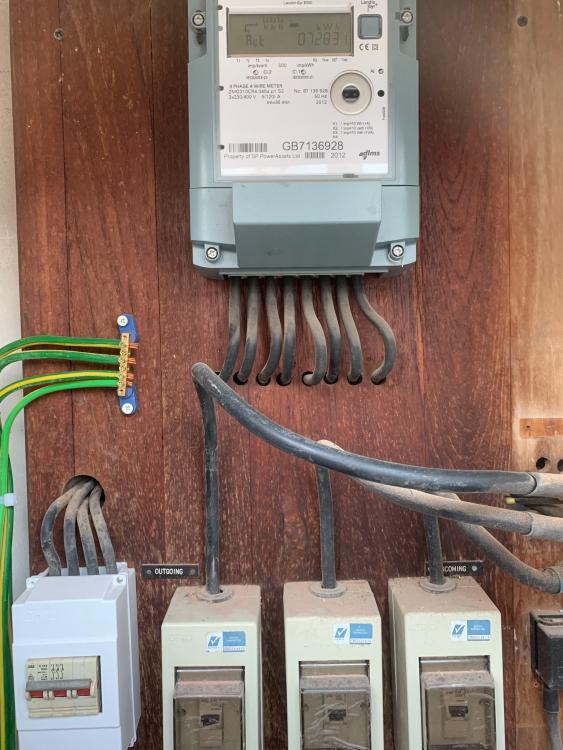

The first picture should be your main gate incoming DB (or referred as incoming electrical panel) because it has your incoming mains and your meter.
It will be difficult to fit the SPD outside the incoming main gate electrical panel due water ingress issue causing trips or safety concerns.  Further, there is a requirement wire length for each phase with connection joint from the MCCB outlet joint to the SPD inlet joint PLUS the length of the earth wire to the ground bar(shown in picture with 2 blue non conducting foot mount) total not to exceed 50cm. Once this maximum length is exceeded, there will be a drop in effectiveness to divert the surge current to earth due electrical inductances.
From what I can see in the first picture, there is still space available but may require re-positioning the MCCB (small white box with some red colored ON/OFF toggle lever) This looks like an old ABB brand item.

Our 3 phase system is using TT connection and usually referenced as 3P+N. So you will need a 4 pole device for all connections. In layman term, you need 4 inlet connections and 4 outlet connections for any single device. Unless you split each phase with 1 device. Example will be the incoming circuit breaker as shown in your earlier post. In that picture, you can see 3 small white boxes and a smaller black box. The 3 white boxes each house a single phase breaker (63A or 100A depends) to connect one of the 3 LIVE phases. The black box is a direct connection of the Neutral phase which don’t need a breaker.
So, if you can find a 20kA times four SPD, it can be used too. Make sure the SPD has 3P+N=4 connections.

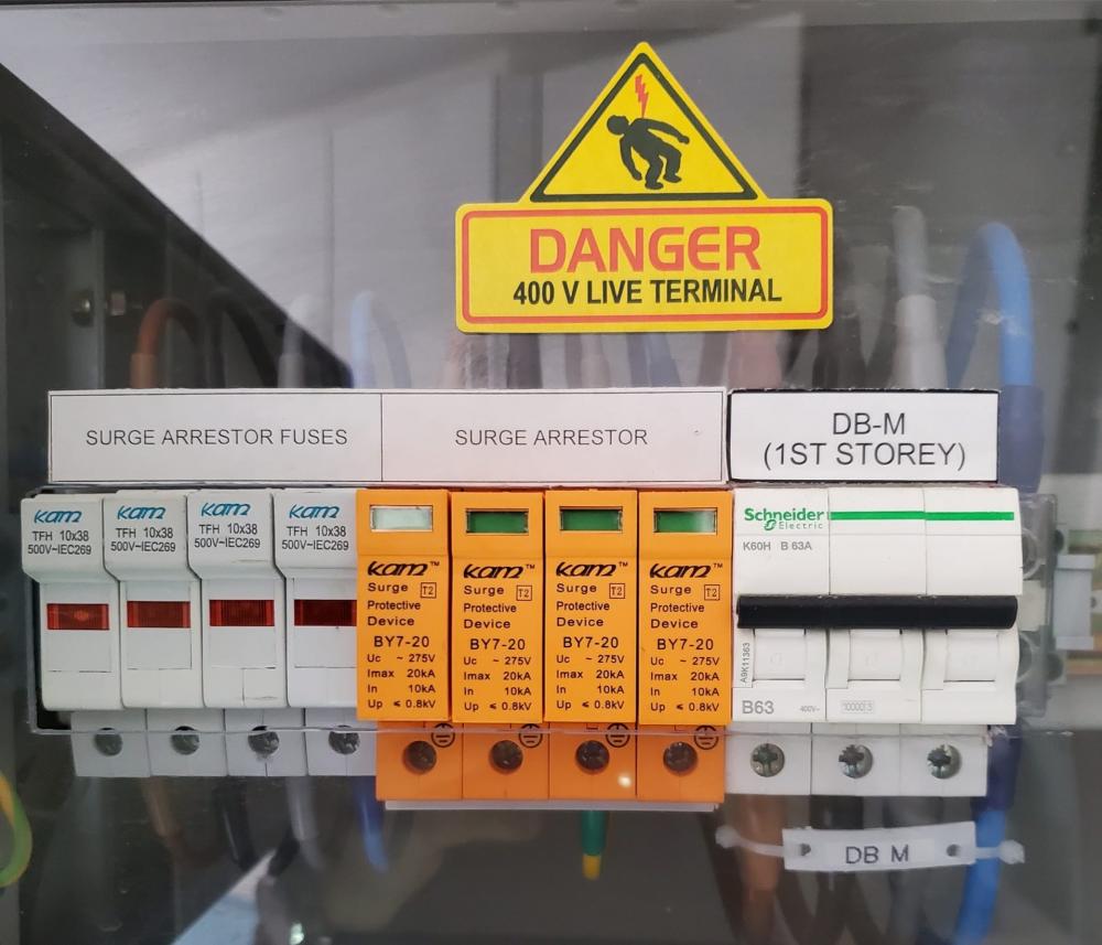

Pete, the SPM440E is a Type2. Did you managed to install any Type1?
Further, the 3 LIVE & 1 Blue NEUTRAL cables tapped from the MCCB inlet connection looks very long. Any one phase cable length + PE cable looks like more than 50cm. There will be a certain percentage of pass through for Type2 surge and if you don’t have Type1 installed, there will be 100% pass through of Type1 surge.

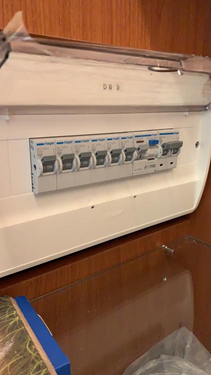

The other area that trips is when there is a direct strike on my roof and there's one switch that trips in the top floor. Hope the SPD in that DB helps.

  On 2/12/2022 at 7:23 PM, petetherock said:
How about these ? My friend is using them in each DB
I asked around previously from electrical supply shops locally and was shown this particular brand ‘kam’ for sale. It’s made in China. Price around $13 each and only single phase available, not 3P+N.
