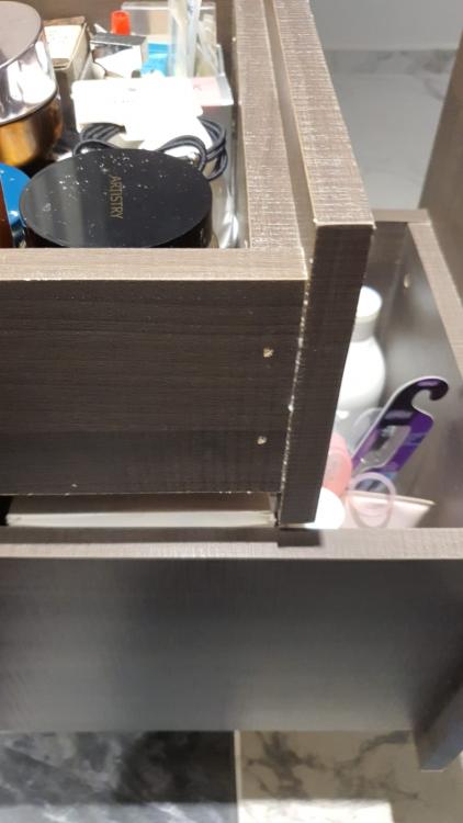

I just move in the house and realised there was mold inside the basin cabinet. I try numerous methods to get rid of it.
But the the mold continue to grow after i had removed it. Do you all have a solution?

Look for and eliminate any active leak or water accumulation
clean thoroughly with anti mold cleaners
apply anti mold primer paint
use a dehumidifier
if all else fails then you’ll need to tear out that cabinet …
