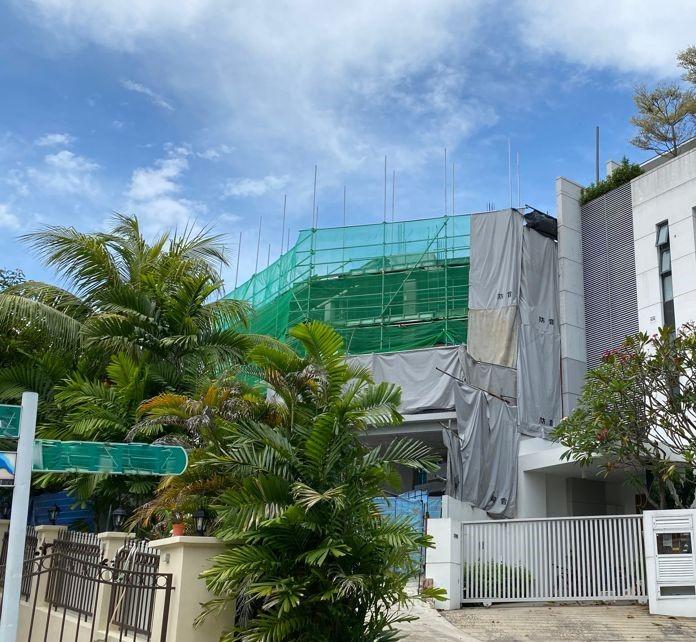

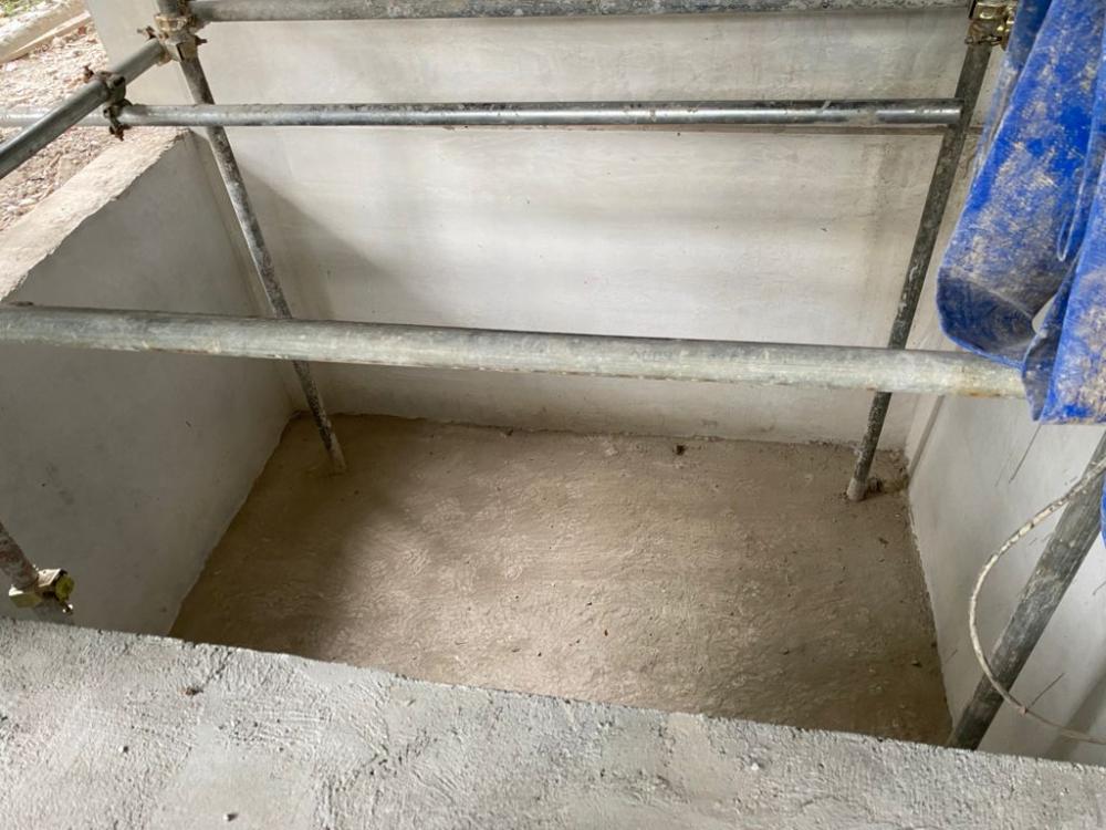

Visited the work-in-progress of my contractor friend last saturday 18 Sep 2021.  I find him very meticulous and efficient. Proud of him. Enjoy!  d :D b
Front entrance.  The adjoining remnant land was previously a PUB septic tank.
Really appreciate the luxury of a 7m height space!! 😍 😊
