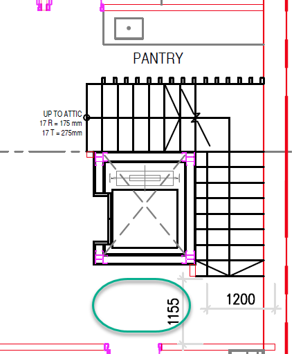

Hi friends, my architect designed 2-flight stairs around lift (8 stairs + 9) as below. I heard that 3-flight will be more comfortable to walk (6 + 5 + 6), after all the green part is passageway.

breaking up the stairs into multiple flights instead of one long flight will allow the legs to "rest" when walking along the landing before going up the next flight.
you as the owner can decide on how you want to break up the stairs as long as your architect can design it such that the minimal overhead clearance of 2m between the steps and the above "ceiling" is met.
if I am the architect, I would design the stairs such that the 3 flights will fit nicely around the lift shaft rather than having one step protruding out at the bottom and top then needing to build "columns" to "block" the stairs. so a 5 + 7 + 5 config may fit nicely as well

Maybe it was already resolved, but do note the implications of changing to a 3 flight thing - the position of the door at the bottom room? How are you going to access it if there are steps in front of it?
Also, the width of the remaining space for the pantry area does not look like it is sufficient. Its probably 600mm now? Need to crab walk inside? 🤣
And your tread width is actually very big @ 275mm. You could be saving space with 250mm. The min BCA standard is 225mm only.

Good observation, Ice. Still in the designing stage, so change the door position.
The panty is a light one serving the floor only.
Specially requested 275mm for comfort, of course, it occupies more space.

Thread width of 250 is quite ok actually. My feet is sized 44 and it feels ok with my stairs of 250 thread width. But since your stairs is wrapping around the lift shaft, ok to use 275 to just make use of the space which would be wasted anyway. Good that you are giving 1200 stairs width as moving mattress up the stairs will be a problem around the bends if it’s just 1000 wide.
if you can increase the walkway of the pantry to 700 would be slightly better. 800 would be best actually. Maybe can consider not having the vertical flutes there to get the extra 100mm. You can find a table, place it at 600 from a wall and see how tight the space is.

Excellent suggestion for removing the flutes 👍 Thanks, snooze :)
