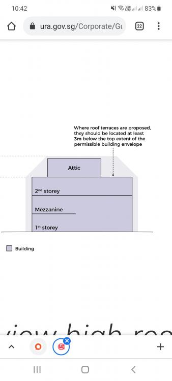

Hi All. Need some help from the Gurus here. I recently bought a brand new semi detached that is 4 storeys high and comes with an Open to sky Roof Terrace.
I am thinking of ways to legally have some shelter in place so that i can make use of that space.

no way you can do it legally if the house is already at its maximum allowed height limit
URA regulation states this "Pavilion, canopy or trellis may be allowed over the roof terrace provided it is located within the permissible building envelope."
since you have a lift shaft going all the way up to the roof, you may be able to add a shelter provided it is within the building envelope.
the question is your 4 storey house is a 3 storey house with mezzanine in a 3 storey landed residential zone or a 1.4 plot ratio zone or not. if yes, then you could add the shelter. but consult a PE as you will need to know what is the structural loading allowed for what you want to construct.

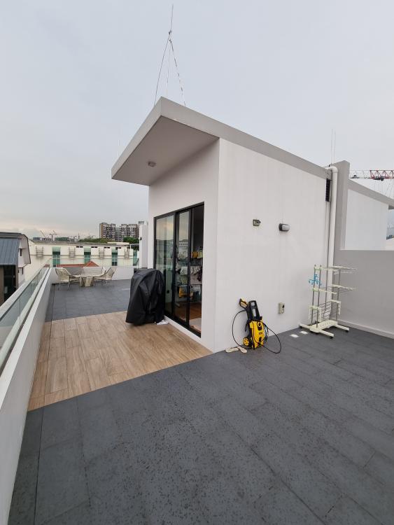

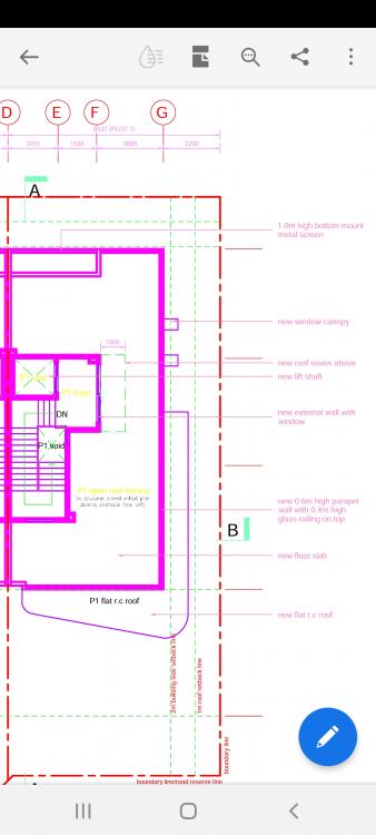

Thanks Snoozee for ur quick reply! I have added some pictures for better illustration
I see my immediate neighbour manage to do a sloping roof terrace 2nd picture.. i wonder if i can do the same? Or am i just going to have to settle on outdoor trellis pavilion.. etc
your neighbour's sloping roof is done to comply with the requirements to be within the building envelope.
judging by the photo, your lift shaft is at or near the 3.5m setback line for the building envelope for the rear already. so if you want to add anything it will be like the slope of your neighbour's house or be below the height of the roof line such that you can go a bit more to the back. basically your neighbour has show you the allowed area you can built for the back already. for the front, basically you need to measure 3.5 from the front edge to know where is the limit you can build your shelter. though you could cheat a bit by adding 1m of additional roof eave but any enclosure must be at or before the 3.5m line

Upon enlargement of your picture, you should note the words "For maintenance only".
There is a reason for this indication on Architectural plans as submitted & approved by the authorities..

also i don't see the words "for maintenance only" even after zooming in the photo 400 percent. if the roof terrace is only allowed for maintenance, i don't think any architect would design for the lift to go all the way up already.
