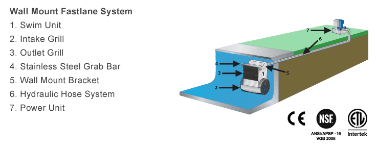

I might add that - you need to work with your builder on the design and choose the counter current system wisely. If it's something you will use a lot, get a good one even if it costs more.
The hole in the side of the pool is meant to fit one brand and sometimes only one model.
Thanks, Pete.... that's one concern i have too. On the lookout for those i can just add to an existing pool if possible so even if spoilt in the future, i would not have that stuck in the pool forever. Eg, Bestway Swimfinity.
