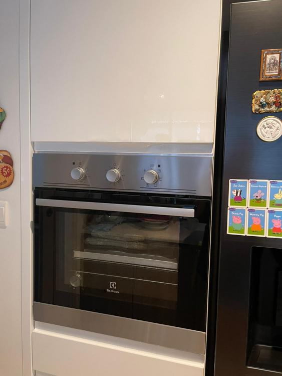

Our built-in oven has gone kaputz unfortunately the replacement model is slightly taller.
We are looking for a carpenter service to do:
1. Shift shelf higher
2. Relign cabinet door
What is the size of your cabinet hole now? Standard oven hole is 600x600mm.
it’s not a straightforward job to shift the shelf as the shelf would have been nailed or screwed on from the outside of the cabinet carcass. So if you want to shift it, you will see the screws for the new shelf at the sides.
not sure exactly what model is your current oven. Searching online seems to suggest that it fits into a 600x600mm hole.
Suggest you remove the existing oven first and plan from there. If you don’t want to remove it, can pull it out slightly and then measure the hole size
