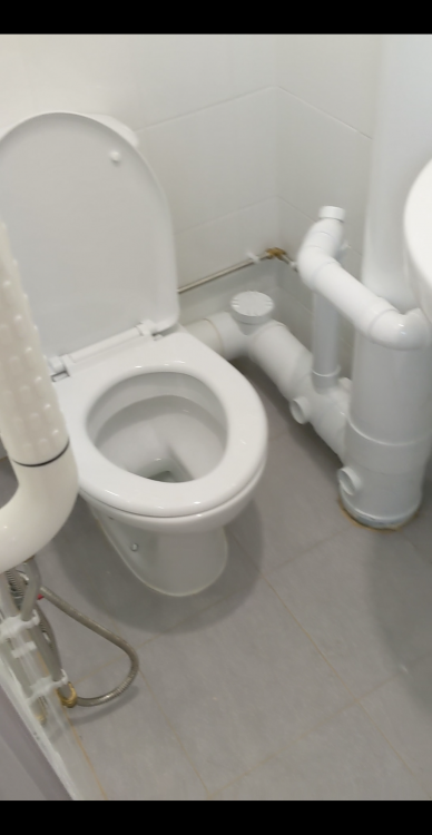

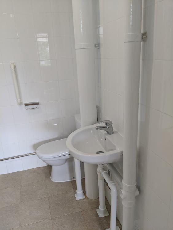

Here's the completed wash area toilet (very tiny, but functional):
And the MBR toilet:

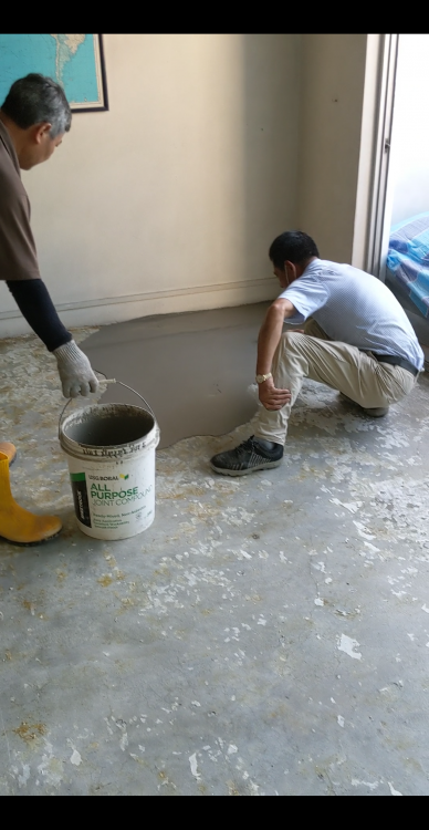

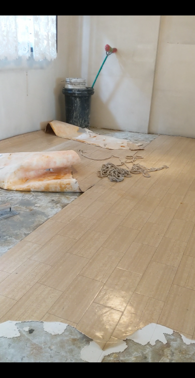

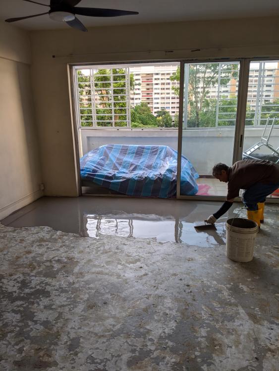

Post HIP handover, we had a couple of days before the flooring guys came in to do existing vinyl removal and screeding. Had a tough time sourcing this one - 1. since I didn't order vinyl through my main con, he was super clear about the flooring company needing to do removal, levelling and laying. My main con had proposed Hafary for flooring including vinyl - but we went down to the warehouse and weren't super impressed with the sales pitch (when asked why the $7 psf vinyl was better than the $3 psf vinyl, the sales compared it to buying a $3 vs. $7 bowl of bak chor mee, and the fact that she personally has it installed for her home, no problems). Not convinced.. so decided to make a call to Evorich (their intensive marketing efforts on the web does pay off) since their warehouse was also nearby. Evorich's sales pitch was 1000x better (some find it gimmicky though) - lifetime warranty on their HERF, scratch proof, water and fire resistant, with improved acoustic quality.
Sold. Made a quick call to main con to check (which was when he emphasised they need to do removal as well). Well, turns out Evorich does not do existing removal and levelling (?!?!!) but the rep could hook us up with his contact. Somehow, he never gave me the contact but that the contact would contact me... so it was weeks of following up til he actually contacted me. All good - they came for site visit and quotation, but on the actual days I think they realised they underestimated the difficulty of the job.
Our vinyl is TOUGH. I believe they must have used extra-strong glue 30 years back to stick it to the bare subfloor, and over such a long period the vinyl had hardened. they basically had to scrape it off the subfloor, tearing the thick layers off slowly.
Took a full day's work for removal, then they proceeded with the cement screed. They did a great job - as I mentioned our floor is extremely slanted, they managed to level it best they could.

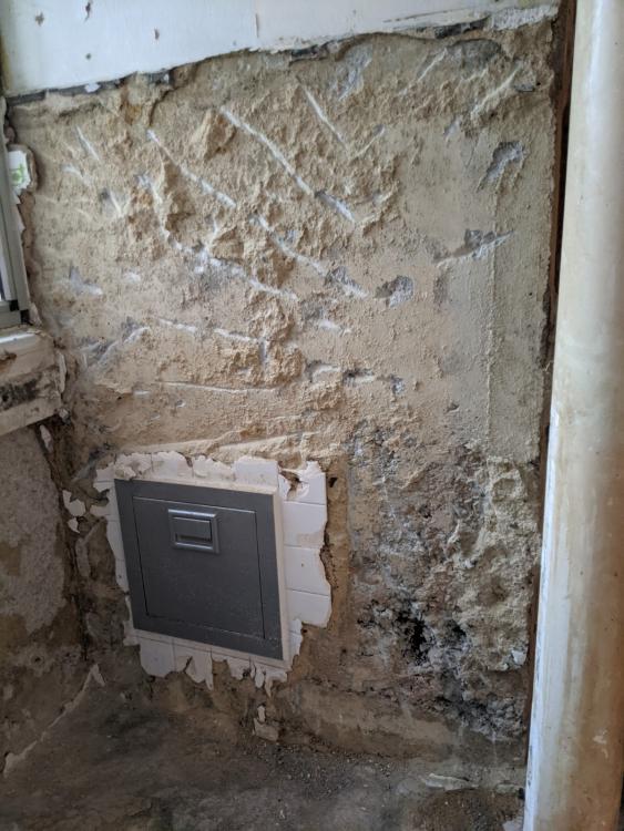

Hacking proceeded without a hitch - guy hacked up the whole kitchen within a day. After hacking they proceeded with the first layer of floor screed, then waterproofing - only to be destroyed by a leaky pipe. Actually, the pipe was leaking BEFORE the guy proceeded to waterproof - apparently, they simply turned off the water mains and proceeded to waterproof. Well.... the pipe continued to leak after that....
Then, main con offered to get his plumber to cut off the leaky portion temporarily while I rushed my plumber to come ahead of schedule to change the kitchen pipe. It's Friday, and main con got his plumber to do the temp job Saturday, so waterproofing can continue. Great. Later, my plumber calls and says Sunday. Then main con says OK if yours coming Sunday, I cancel my plumber. (you can see where this is going..). Saturday night, my plumber calls and say sorry cannot, only Monday afternoon. Oh well, so I told main con to shift waterproofing back to Tuesday.
Lo and behold, screed/waterproofing guy shows up on Monday still. First time I met him and the guy has a **** of an attitude. Came in and ranted about how the plumber was so slow, how he was hoping to do some wall screeding work and had to wait for DAYS already. Told him that he's not supposed to be here today, today cannot do, come back tomorrow. He ranted for a good 10 minutes before leaving.
Tomorrow (Tuesday) rolled around, guy does not show up. Main con did not have a satisfactory answer as to why. Assuming he will show up tomorrow.
Oh, joke of the century (for my main con), we insisted for the chute to be left there, because he said the chute is usually removed with hacking with a big hole there before screeding and tiling. We insisted no way - we're living on a low floor and pests would come up etc. People throw things down, and sometimes chute gets washed and fumigated. And well, it hasn't been "just a few days", it's been a total of two weeks since our kitchen was hacked and til now not even the wall has been screed.

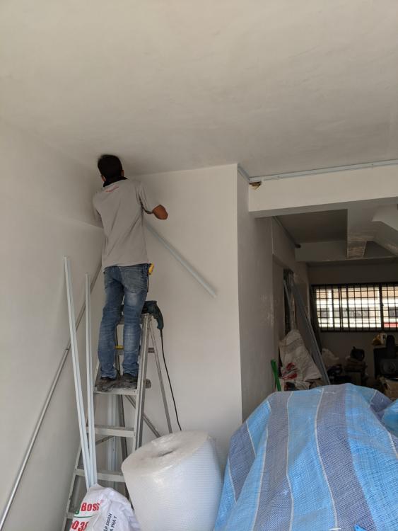

Electrical team also started work this week - 4 days in total.
Day 1 - casings / Day 2 - cablings / Day 3 - hacking / Day 4 - install DB box
Electrical team was also satisfactory - could advise on ideal placements of sockets and casings. One was more meticulous than the other (cutting casings neater, laying them in line with ceiling, being quicker with the drill etc.) Yes they could be faster, but the difference is not significant (perhaps another team could have finished in 3 days).

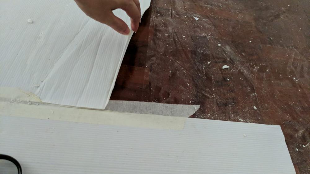

Oh, one thing I'm very frustrated about is the absence of floor protection for the parquet floors upstairs. Somehow, our bedroom floors were not fully protected (despite main con emphasising double layer protection at the beginning of reno) - the floor protection guy came a total of 1 day and actually did not return after furnitures were moved away from the walls. And the plastering team proceeded on the unprotected floors (I assume they assume we were going to redo our floors as well) and now my parquet has plaster and scratches. When confronted, main con gave several reasons - our furnitures were not shifted out earlier, lack of manpower from floor protection side, tight timeline.. all unacceptable. The least he could have done is told us about any lack of manpower/ inability to fully protect, so we can lay our own floor protection, instead of waiting for us to find out about the incomplete job.
Partly our fault also for not checking that all floors were protected. Told the team to remove the plaster stains and revert our floors to normal before Nippon comes in to do pre-painting floor protection. As for the scratches, I've done a quick Google search and found a pretty well-reviewed parquet restoration service, so I might have them come and take a look after painting is done.
May also have been complacent, given HIP's high standard of floor protection -they'd used thick PVC sheets- thought private contractor can not do worse..
In comparison, my contractor's "double floor protection" was a layer of white PVC board followed by cardboard (in the bedrooms, they didn't even put on the cardboard). I'm thinking what I could have done back then. Ask for more details about the floor protection? It's such a basic job that I didn't have to? And contractor had surveyed my house and emphasised double floor protection for our parquet flooring, so how did it come to this 😠Oh well, what's done is done.

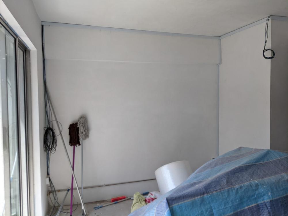

Electricals progressed - they did some hacking today and I'm hoping they finish up tomorrow. On one hand the men say their boss told them to go to another job tomorrow, on the other hand the boss promised me my place will be finished by tomorrow. I can't wait to find out what happens.

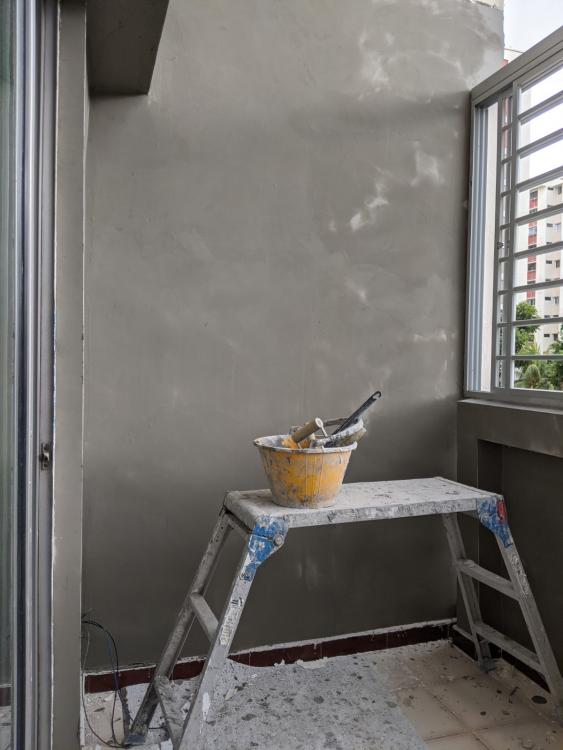

Kitchen screeding/waterproofing guy came today - did the walls and the balcony too. Pretty satisfied with the work - they did the parapets well. The balcony looks so easy on the eyes in grey ☺️. But we'll have to paint it back to white.

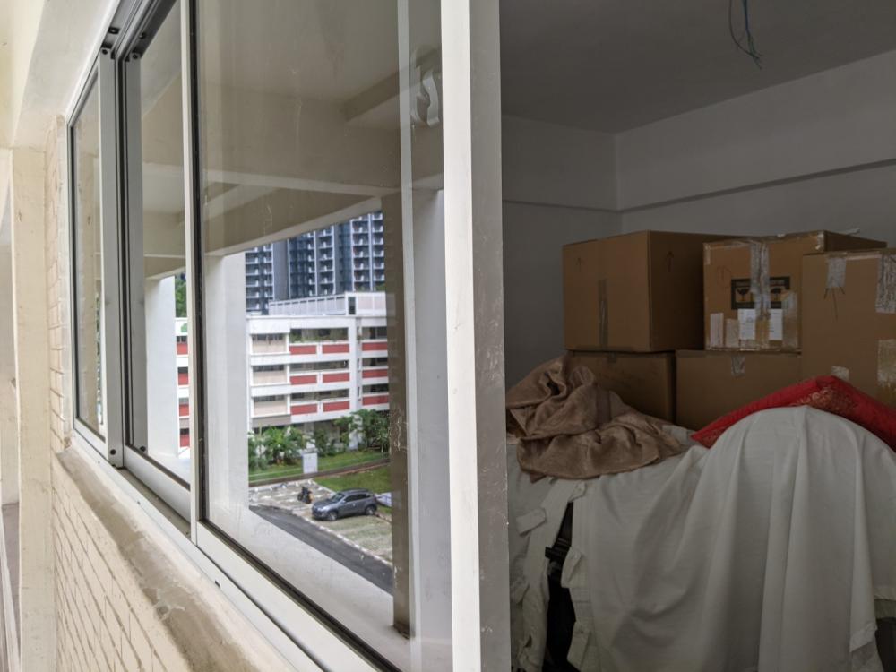

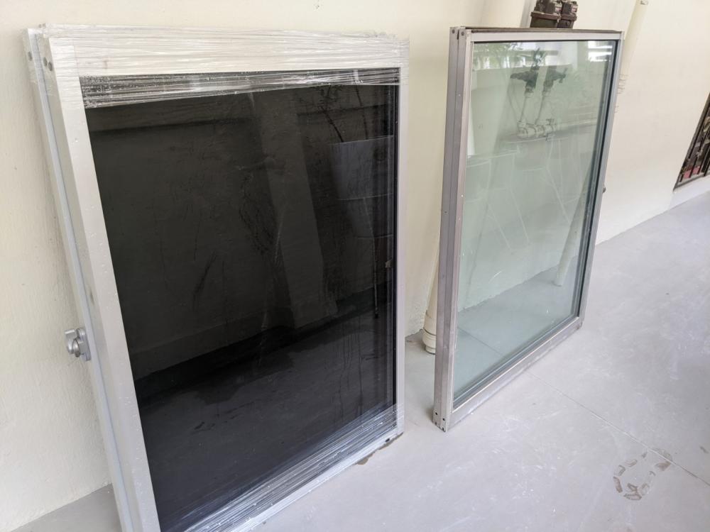

Windows also arrived today - the new ones on the left and old on the right. The new ones are 1-way tinted, but the tint is darker than i expected (pretty sure I chose light tint but this looks dark tint).

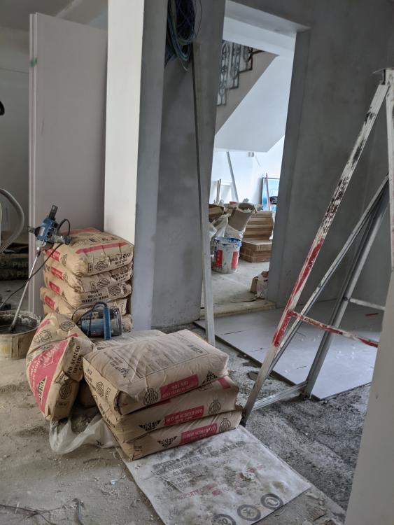

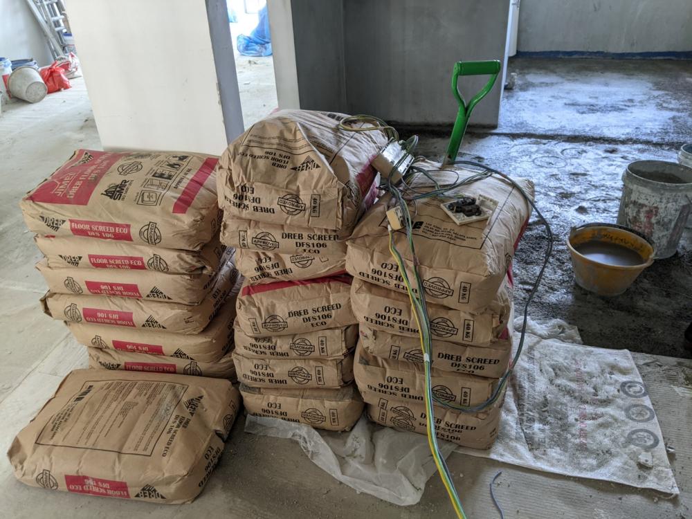

3 weeks into the reno and 2 weeks into phase 2HA...
Basic works are almost done (hacking, screeding, plastering, rewiring) and most of the packs of cement, plaster, cables and tools are cleared, freeing up more space downstairs. Tiles will also be used up next week.
Finally, we can start to think about the aesthetics of the place.

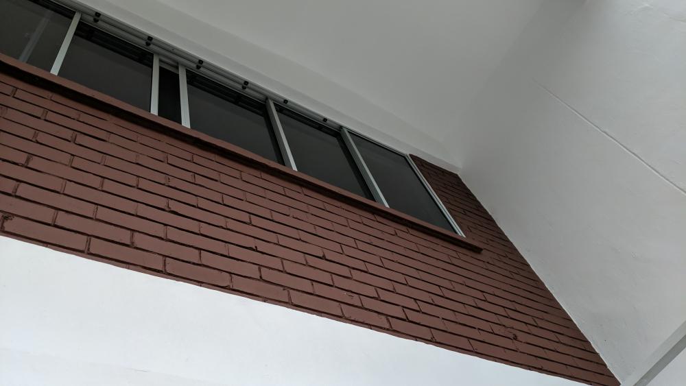

We're going for simple, so actually paintwork will be mostly white -
Living + Dining: Nippon Sail White
Bedrooms + Kitchen: Nippon Snow Flakes
Balcony: White + Newtowne Brown for the bricks
But also wondering if the entire house will be too starkly white. Tempted to paint several walls black but my parents would most certainly run me over. I do love the black and white look, but they love colours. There's several walls that we could do up as feature walls, still deciding on which and how.

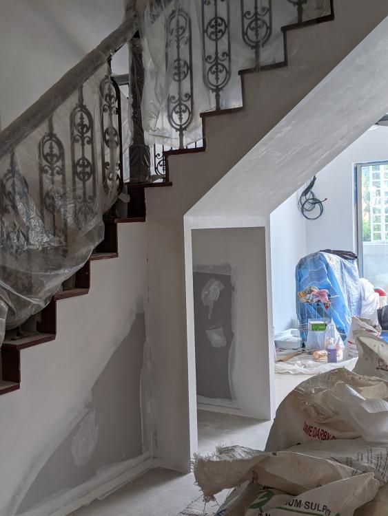

Partition walls of the storeroom under the stairs was also done up, along with over the kitchen countertop. They use this laser level measure to ensure the partition is straight. Ensuring anything is straight in this old HDB is honestly tough - even our ceiling beams are significantly longer on one end 🙃
For the storeroom, there's this beam that is an accident hazard everytime you back out of the storeroom, you'd most certainly hit your head. My main con says it needs to be there for the door frame. Thinking of getting foam edge protectors and nailing them on there.

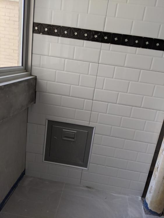

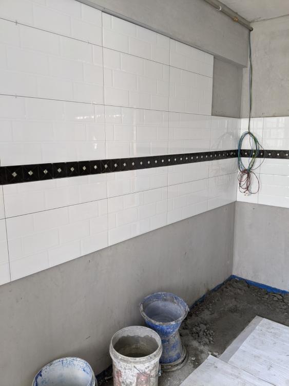

Kitchen subway tiles are up, including the mosaic, all from Hafary. It looks great - really happy with the tiler's work. The final look is with white grouting though - and I'm not sure how that would blend with the black mosaic. We wanted white grout for the white tiles + black grout for the mosaic, but main con advised against that as the black grout may stain the white tiles/ white grout over time and we didn't want to take that risk.

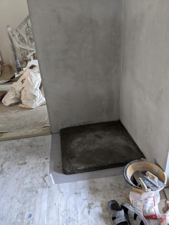

Fridge base has also been constructed, 850mm width by 800mm depth. Should be sufficient for most single-door fridges. We don't have a washing machine base as the washing machine does not have a logical spot of it's own anywhere in the kitchen. Main con said it can't be placed in the balcony (we can't use the balcony drainage to drain washing machine, so it will be sitting up against a wall outside the kitchen toilet on a moveable base.

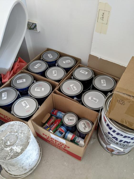

Paints were also delivered for tomorrow 🙂

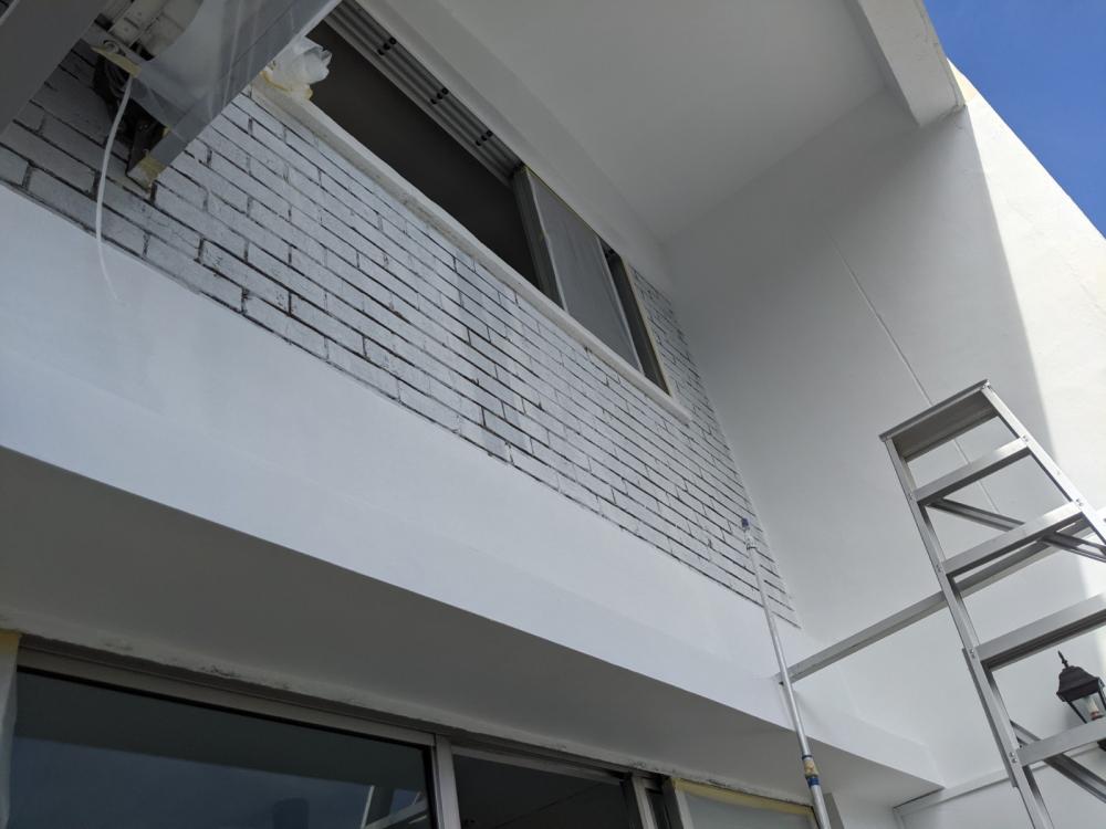

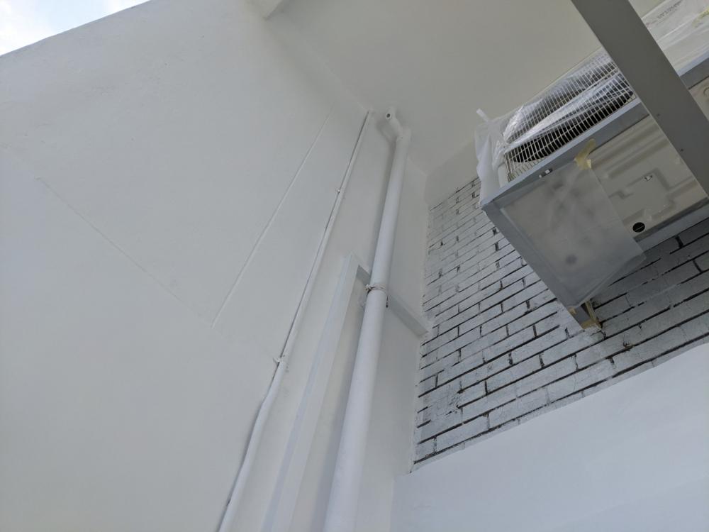

So, the paint job by Nippon went on without a hitch (post the vaccination hiccup). The job was quite straightforward as our house is completely in Sail White, except for the Kitchen and Bedrooms in Snow Flakes, and the TV wall in Pure Gift (light grey). The difference is subtle but Sail White has a tinge of yellow in it so it's more warm, Snow Flakes has a tinge of pink in it and it's more cool. Ceiling was in Anti-mould, and it looks to me slightly grey-ish. Not a bad contrast to the walls.
If you recall, the reason we switched to Nippon over my main con's painter is due to the latter inability to paint 2-storey balcony. It's really tough, requires a lot of safety precautions and plastering the top half of the balcony is impossible (without full scaffolding). Nippon did a fantastic paint job on the balcony, very thorough with the sealant and paint coats. Our bricks are in Newtowne Brown, as the original colour since 30 years ago is no longer on the market.

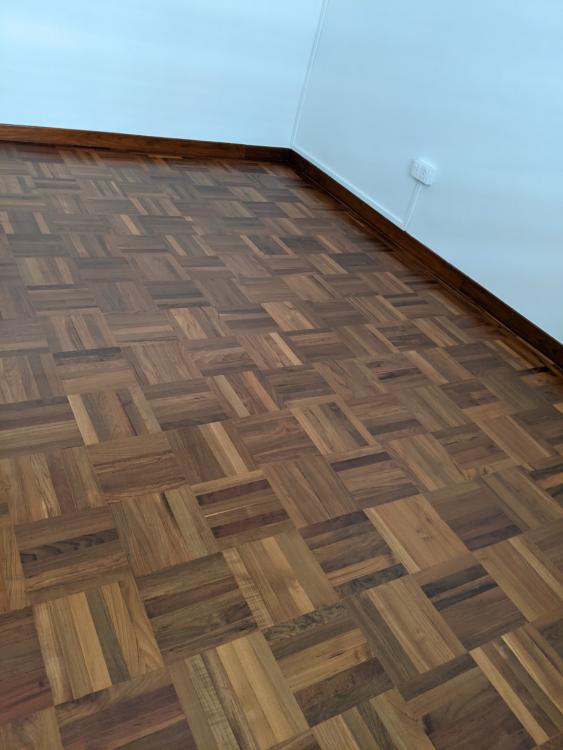

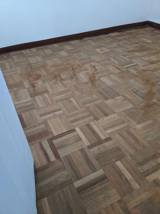

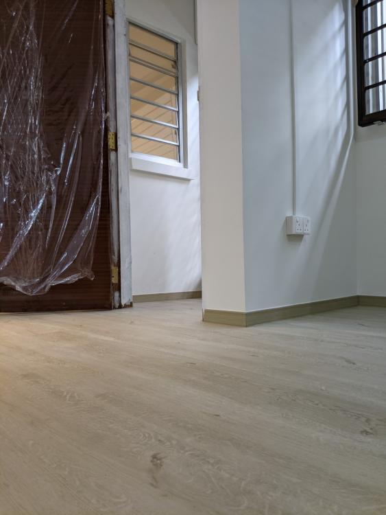

After painting, the parquet grinding guys came to work on the bedrooms. Quite anxious about this as our parquet is as old as the house, generally good condition except for scratches over the years. This kind of square parquet is also no longer available in Singapore. The last thing we want is for it to pop or deform and have to replace the entire upper flooring.. thankfully, the grinding was a success and the parquet is now smoother, gaps filled though some strange tiny bumps appeared after the grinding. I really love the differing hues of the planks and am hoping this parquet lasts for 30 more years!

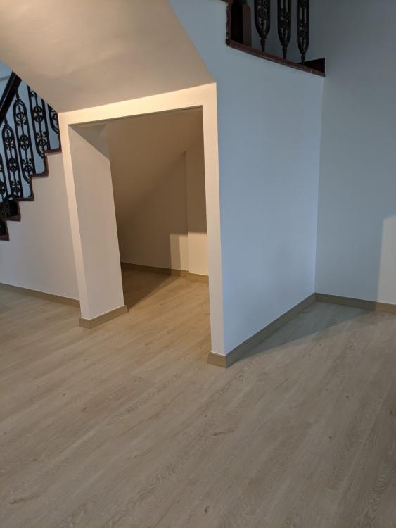

Downstairs flooring was not much easier due to the unevenness of our subfloor (old HDB). There's a particular spot near the Utility area where a wall was hacked, so the vinyl installer has to apply lots of silicon there and there's an obvious darker patch.

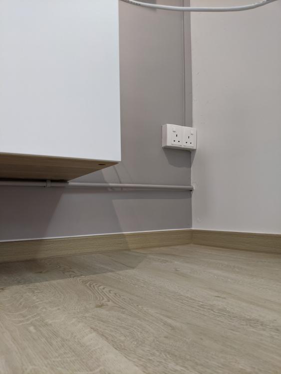

Otherwise, rest of the Living and Dining areas looks good. This is Evorich HERF in Amsterdam Eggshell, they delivered the planks day before for acclimatisation, and came to complete the job the next day.
One thing I wish I had known - they had to remove our new door and shave it off for clearance as the vinyl planks are quite thick. The door isn't quite the same after hinging it back on, and a little damage was sustained too. So if you can, leave your new door installation to after flooring is done.
The Evorich HERF planks ($6+ psf) have a little grooves in them, so they probably are going to be a bit harder to clean vs. those vinyl that are super smooth. But they are definitely sturdier and handle item drops better acoustically than some others in the $3+ psf range I've seen.
