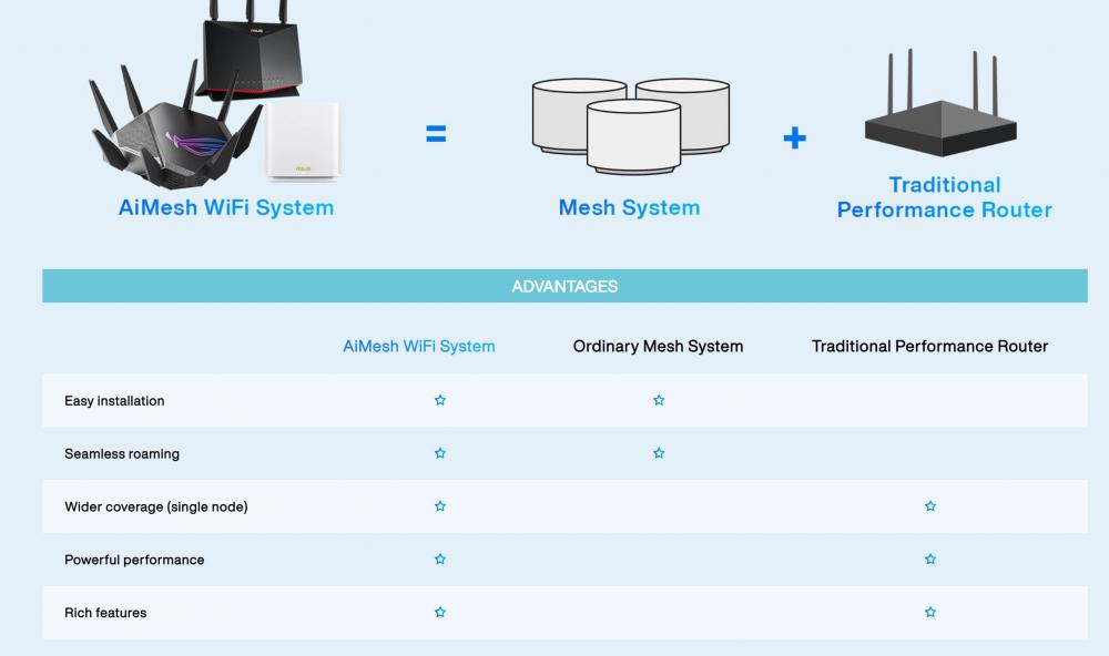

I'm using multiple Asus routers which are all using ethernet backhaul. Aimesh is Asus'  mesh network system that turns their routers into APs.
So you are essentially paying for a router but just using as an AP instead.
not sure how much your routers cost but I think still cheaper to run a POE AP since don’t need to have extra power socket
How many routers do u need? Do u place one in each floor?

Yes, I have one on each floor. To @snoozee's point. a single POE AP is very likely cheaper than a router. However, in my case, I already had 3 existing Asus Aimesh-compatible routers. In addition, I got another free one by recontracting with M1. Another pro tip is it's cheaper (around 20-25%) to buy Asus routers from Taobao. No warranty though and you need to switch the default Chinese firmware to English in the settings. I
