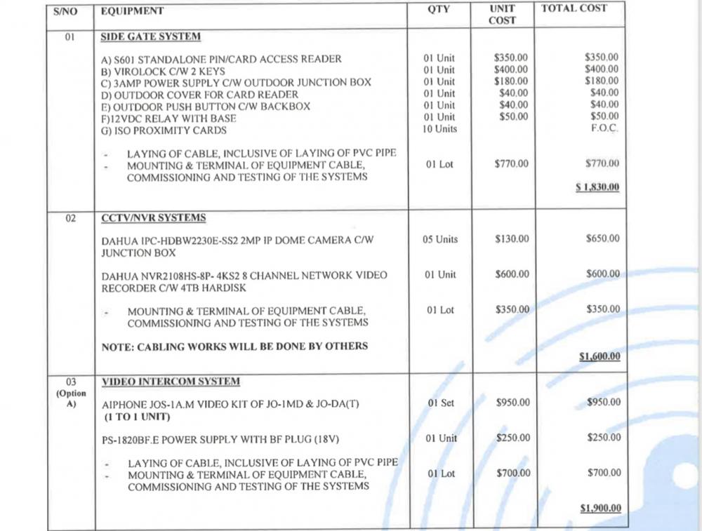

Hi,
Can I check if the pricing listed here are reasonable? Is a 2MP cctv from dahua sufficient for viewing purposes? any feedbacks regarding dahua cctv?
and if anyone can explain what a POE switch is for in layman terms? I tried to Google about it but got confused. And do I need a POE switch at every AP?
Thanks!!

i'm using dahua 6MP CCTV. 2MP resolution would be very poor. you can pay for 8MP or even 4K resolution CCTVs but they would be much more expensive.
POE means Power Over Ethernet. for conventional CCTVs running on coaxial cables, you will need to supply another 13A socket such that a power brick can be plugged into the power socket to provide power to the CCTV. But for POE devices, the power is drawn through the same Cat 6/7/8 cable from the switch which also provides the power. So basically you just need a single ethernet cable to transmit the power and data. It's much more convenient and you don't have to pull separate set of power cables to provide power to the cameras.
Every POE CCTV camera will need to have a single ethernet cable which is connected back to the DVR which has POE capabilities.
AP is Access Point for WIFI which is different from CCTV unless you are buying wireless CCTVs which is another topic on its own.
For the quotation, let's just say you are paying for warranty (I hope at least 1 year) and also the labour needed to install the system for you. if you really want to know how much is the equipment cost, you can always search online for the individual equipments listed to find out the pricing.
For me as I can DIY the installations, etc, I basically paid a fraction of what you are quoted. The only things I couldn't DIY is the laying of conduits and cables so this part is done by my electrical subcon as part of the building cost.
Hi @Mandm
You will be paying a very significant marked up portion of installation costs. For example, the Dahua 2MP camera can be found at Lazada for approx. half the price.
Like Snoozee, I'm doing the setup by myself and use my contractor (electrician) to just lay the cables.
