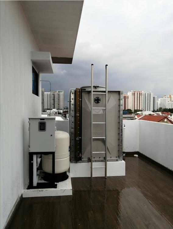

Is building a stairways up to the attic level considered increasing gfa? And would making the attic accessible and usable as a bedroom be a cheaper alternative versus extending to the rear for extra bedrooms?
And if there is  water tank at the attic, is moving the position down to first floor recommended for easier future maintenance? How can one check if we can go without water tank?
If extend level 3 up to x2, you need a PE to confirm if the foundation can support the new beams and columns and roof for the 3 storey or not. If foundation can support, then no need to touch the foundation. If can’t support, then doesn’t make sense to just tear down level 2 and level 1 at X2 to do the foundation and then build up again. Might as well extend all the way to 2m or 3m from rear boundary already.
staircase will be part of GFA so no difference have or don’t have. Once you extend the floor plate, it is counted as additional gfa.
You want to use attic as rooms means you need to add a physical floor which will increase your cost as well
if your house highest water point is beyond 125mrl or 25m above Singapore datum, you need a water tank somewhere due to low water pressure. It might be possible to shift the tank down but it will take up space which you may want to use for other purpose. This will also mean your house plumbing needs to be redesigned to  accept the inlet from first floor rather than from the attic/roof.

Roof is the best place to put the water tank in my opinion. Mine is on the ground floor and it takes up space and is an eyesore. Maintenance is typically just annual tank cleaning so not a big issue. Should try to reduce scope of work to shorten timeline where possible so you need to decide whether the tank relocation is really necessary. Moving the water tank also requires licenced plumber to do PUB submission.
