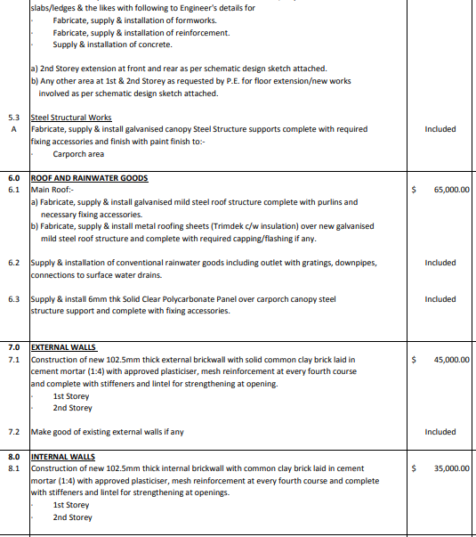

Can I check regarding visuals? Whilst I have been speaking to builders, they do not provide visuals for now because we have not commited to them. They have given us a detailed price breakdown that mentions
Is this dangerous signing without a visual? Like will it be very hard to negotiate what we want later in terms of design in your opinion? I am worried I sign and they say "oh if you want this u top up, if you want that you give me extra $$".  TIA

is your quotation for extension work? cos i see an item mentioning "extension". They are also proposing Timdek roofing sheets so do a search and see if you like the pattern of the roofing sheet or not. There's other patterns of metal roofing sheets if you don't like this pattern but of cos cost may vary.
since you haven't signed anything, the builder also won't commit to anything and do more than what is necessary to close the deal. if your concern is about cost due to design changes, then you should appoint and architect first and do up the entire design before looking for a builder. in this manner, you will be able to see all the 3D renderings and finalised the design aspect. Then the builder will quote based on the tender specifications drawn up by the architect and there would be no dispute since the quotation is already based on finalised design. Also by calling a tender, all builders invited for the tender will quote in a standard itemised format drawn up by the architect and you can do a proper comparison as well.
