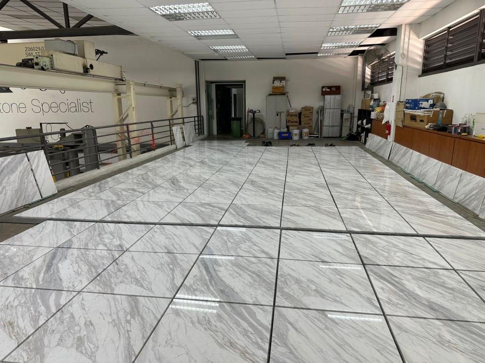

For living room floor, architect has proposed Volakas white marble. Anyone has feedback on this material please?

volakas marble is mainly white with darker grey veins so search online for photos and see if you like the look of the marble or not. Marble is very nice but you also need to maintain it. After installation, make sure to polish and seal it properly. Also any spillage must be wiped off immediately to prevent staining. The sealing of marble buys you time for clean up but doesn’t mean it prevents the spilled liquid from penetrating the marble if left for some time. Other than that, regular cleaning with water should be done to maintain the shine as well. In short, clean marble like any other type of tiled flooring but take special care when it comes to spills.

Volakas marble is nice! Especially the gold vein Volakas.

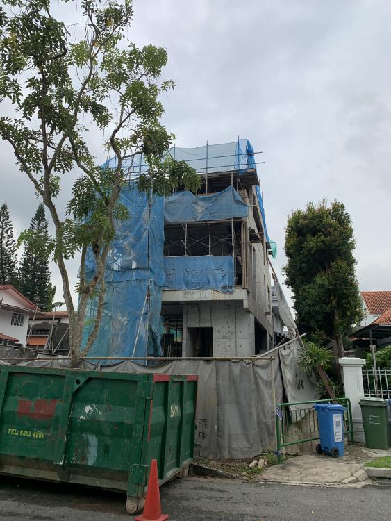

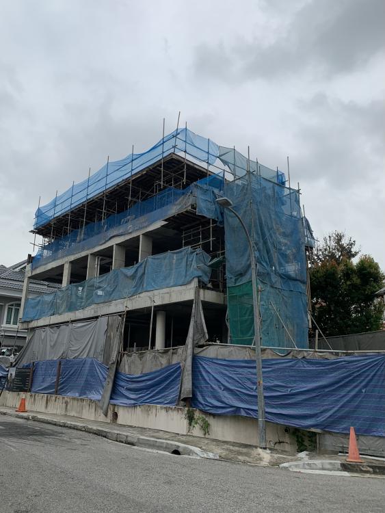

After 8 months, can see the shape of the house now!
Looks good! Wondering though... the setback from the gate looks quite short. Or is this the side view?
should be side view. very expensive house.🤑

Haha, no it’s the standard 7.5m setback, it’s just the angle of the photo. This one may be more accurate view.

haha ok. perspective playing tricks on the eyes. you got permission to cut down the tree in front or it wouldn't affect your driveway access?
Snoozee, you are very sharp. We received approval to change the front access to the house so the tree will have to be moved.
