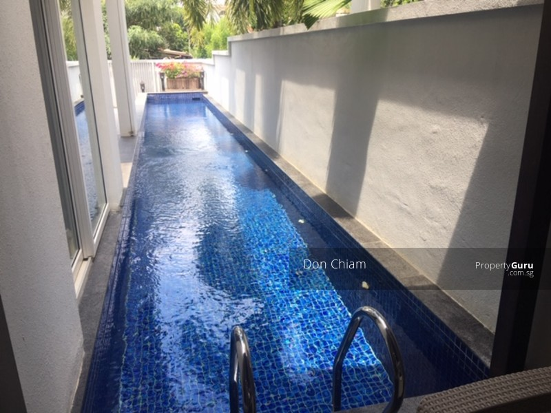

I got this off a propertyguru ad.. I think this is about as narrow as you can get. But it will fit nicely.
Look up "Bungalow with Elevator in Changi District 17"
Can't post links here...
