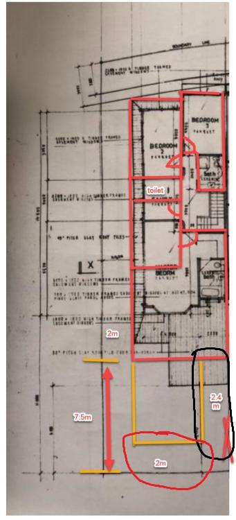

In your sketch you indicate another 2.4 metres from side party wall to side of car porch roof!!! I'm simply stating this is wrong.
I've attached your sketch to show the mistake.
1) Circled in black can be extended to the side boundary where the "neighbor-shared" party wall is
2) Circled in red to maintain 2.4 metres from Front edge of Car Porch Roof to Front Boundary where the Main Gate is

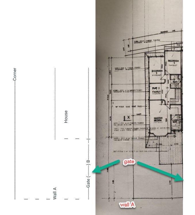

please do not be so ignorant to think that all corner terraces must have the same layout as what you envision it to be. a corner terrace simply means that it is a house at the end of a row of terrace house but no where does it say that is must have the same front/rear boundary as the house it is joined to.

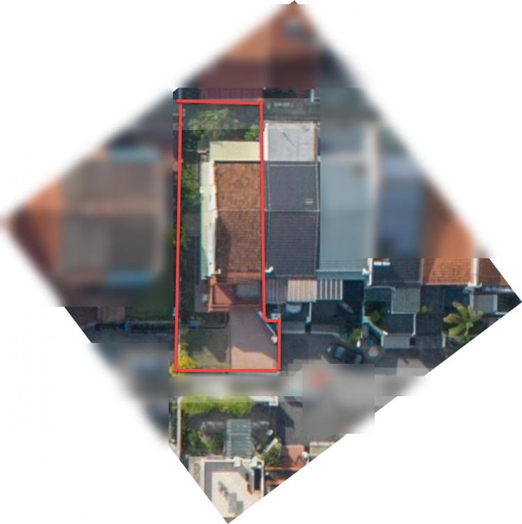

TS already mentioned that the house has a uncommon layout where the gate is on the side and not the front. this clearly shows that the boundary of the house is different from the adjoining house. I had also mentioned that I had seen a map and saw a house with a layout similar to what TS had mentioned hence my drawing is based on the map information I had seen as what TS had provided does not show the entire full picture.
if you had not seen TS's post on the uncommon layout, I had superimposed her sketch along with the floor plan to make it clear. I have also attached the map image of a house with a layout similar to what she had described.
so with this information, tell me how can the car porch roof can be extended along the party wall (wall B) all the way to 2.4m from wall A when wall B itself is NOT a party wall but a front boundary wall. with the access point (gate) being on wall B itself, URA requires that the car porch roof can only be up to 2.4m from the gate itself which means wall A is no longer a frontage but a side boundary and the car porch can be up to 2m from this wall.
