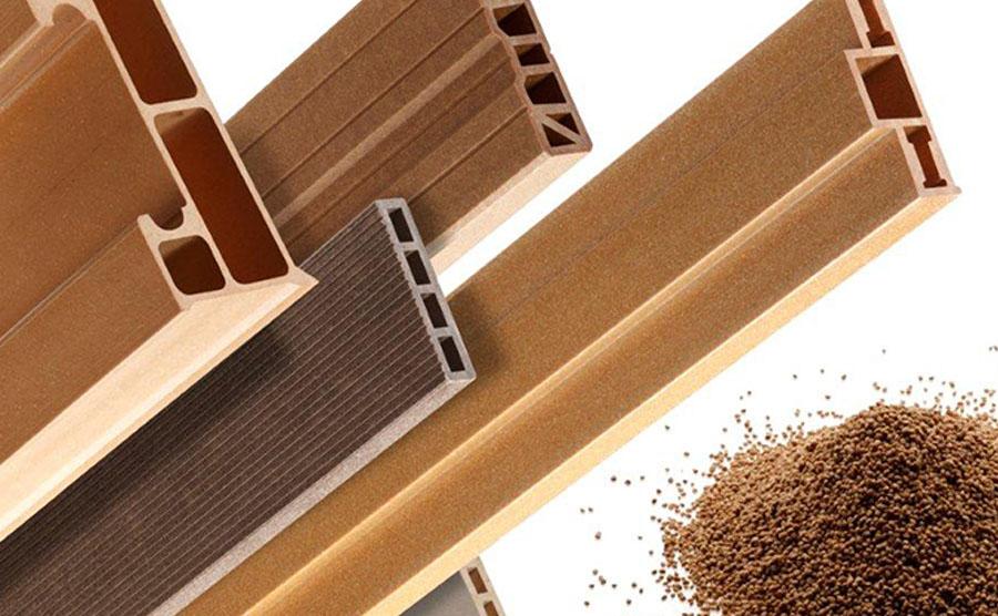

With the development of wood-plastic industry, people gradually realize that using waste plastic as the raw material in wood and plastic industry is an effective way to solve the recycling of waste plastics. Wood-plastic composites have a variety of mechanical properties better than wood and plastics, wood plastic products have better dimensional stability, low water absorption, will not produce warping, cracking and other phenomena like wood. Because the substrate added in wood plastic products is thermoplastic, so in the corrosion resistance and acid and alkaline and other aspects have incomparable advantages, its service life is also relatively long.
Recycled waste wood-plastic composite products can also be used as new fillers in the addition of new wood plastic products, its performance will not change much. Wood powder used in wood plastic products is often the wood preparation process produced by the scraps of wood chips, sawdust and some plant fibre substances such as peanut shells, coconut shells, sugar cane, linen, jute, cannabis, etc., in the raw materials problem wood plastic composites need the price of fibre is much lower than the price of wood raw materials. For plastics, due to the addition of wood powder, its mechanical properties have been greatly improved, such as wear-resistant relative to plastic on the average increase of about 35%, at the same time wood plastic composite products also have plastic easy to process and other characteristics, but wood-plastic materials also have their own limitations and problems.
