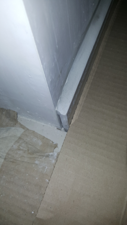

How thick should homogeneous flooring skirting be?
 Hey guys
Just came back from my new flat which is under renovation.
Today tiler did the skirting and they are 2ish cm thick and when came to slant wall the skirting is 3ish almost 4cm thick.
Are these normal?
Please advice.
Thanx for ur reply Andrea
Here are the pics.
ID said it thick because we are using ceremic tiles, but seems like its because of the wide gap the tiler left between the wall and the skirting tile.
well, you can either have a zigzag skirting with even distance from the wall or a straight skirting with uneven distance from the wall.
I guess the main issue is that the wall isn't perfectly flat in the first place. hence the tiler have to do what he did to keep the skirting straight rather than leaving it zigzagged.
Looks weird. At first i tot u took a photo of ur aircon ledge. Skirting normally shld be below 2cm. My yard homo tiles skirting measures 1.5cm. If its gng to be covered by built in cabinets then it wont really matter i guess
