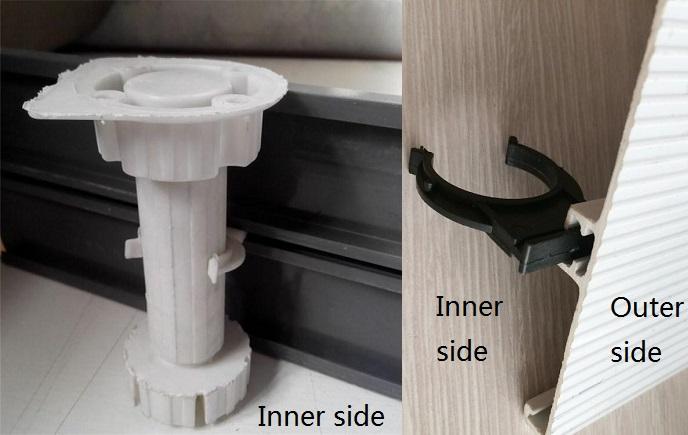

Obviously, the cabinet is not sitting on the floor. During installation, the plastic leg is attached to the bottom of cabinet. Leg stand on the floor and cabinet is sitting on the leg.
For the working principle. attach the leg to the bottom of cabinet with screw. There is a cover clip and attach the cover clip to the leg. The leg is adjustable from 50mm to 100mm. Each leg can be load 30kg.
All the legs are taking load and cover is not. Both leg and cover comes with plastic or aluminium. There is also another way: the cover is attaching to the bottom of cabinet.
