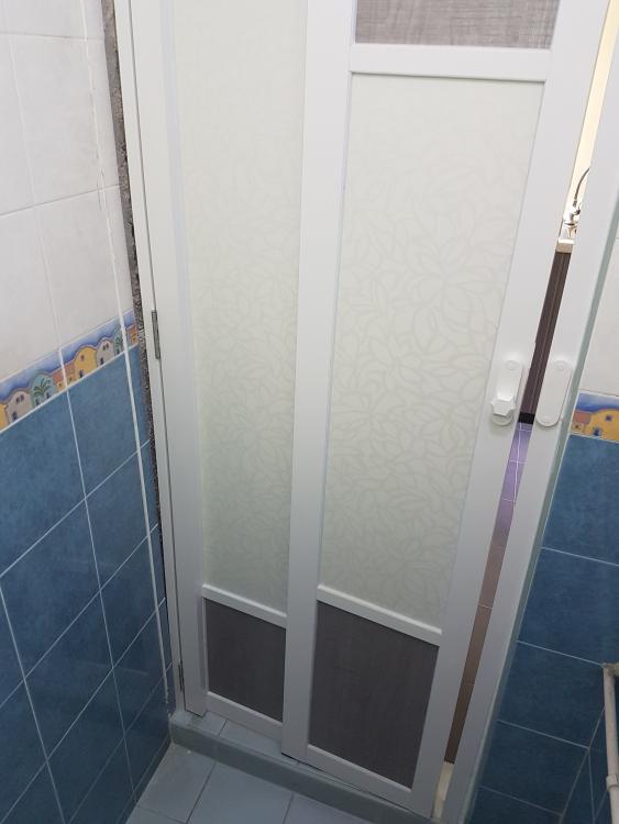

Then come the day of installation. For some reason, after installing one side of the frame to the wall, they told me in order for the door to be straight and for it to close, the other side will protrude out if not the door will not close. So, I said you of course need to install in a way that the door will close. The end result is in the attached picture. It is very strange that the door needs to protrude out for it to close though. I later checked with another contractor the following day that this must be a mistake they made when they first install the left side. Now there is a sharp edge and my family said that is very dangerous and could hurt anyone.

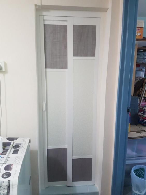

So for the second door, I told them to slant a bit so it does not protrude and the end result is in the attached picture. The whole door is extremely slanted and pretty ugly.

Firstly, like most renovation company I dont think HDB Door Pte Ltd manufacture PD doors, they take your order and install for you.
Looking from that, I am not 100% but I think you can:
1) have a tiler/cement guy to extend the kerb on the inside of the bathroom such that, the sharp edge is not protruding out.
2) tile the door from left right, such that the sharp edge protruding is on the other side, not sure will that cause more hinder.
3) get them to smooth the edge of the protruding point to minimise the cut (fingers crossed)
Hope it helps :)

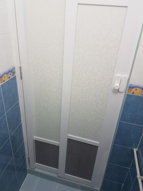

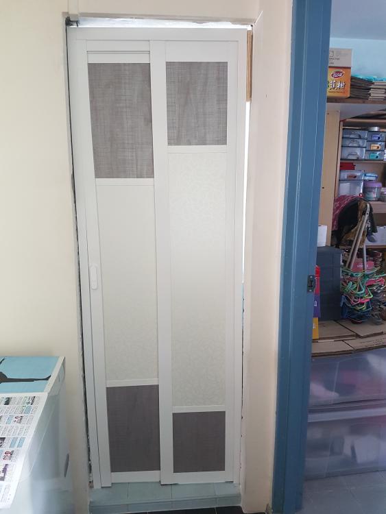

@RobinHo0d: Thanks for your reply
I got another contractor to come and fix these. The first door the contractor helped to file the sharp corner so it doesnt hurt anyone. The second door I had to pay extra costs to get the contractor to dismantle and reinstall the entire door to make it straight.
See pictures attached. So much better now.
