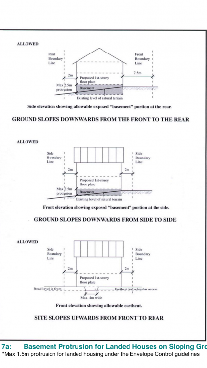

Depending on where the house is, if it's in a low lying area, the house will need to be build above a minimum platform level (MPL) of about 104mrl. So depending on how much the current ground level is below this MPL, you can do some excavation to build a basement as anything below the MPL would not be considered as an additional storey. But do note that for basements that have exposed sides (because of semi-d), the maximum allowed basement exposed level is 2.5m from basement finished floor level to 1st storey finished floor level. Unless your basement is fully covered on the rear and sides then you can have a higher inter storey level for basement.

Not quite sure what you mean on requirements for basements with exposed sides ... what is "maximum allowed basement exposed level"?

For semi-d, the side of the house is exposed. Normally this will be first storey. But if your basement is also exposed on the side that is not joining the neighbor, then it is limited to 2.5m if not URA will consider it as a storey and not basement. Unless your basement is fully underground then the 2.5m limit won't be there.

Thanks Snoozee! I have come across a house (semi D) before where, due to the slope on which the house sits, the back half of the house is one floor or half a floor higher than the front. I have some queries:
(1) Would it be possible to dig out the back half to level the slope so the entire first floor sits on the same level? Any idea how much this levelling would cost if I am reconstructing the whole house?
(2) This also  means the back neighbours and those at the side will be much higher (about one floor) than mine. Any potential issues likely with that? Scared of landslide .... since my back boundary wall would have to "hold up" the back neighbour's house...
land excavation is generally not advised though URA does allow on a case by case basis. however you need to bear in mind that if you are going to level the ground, you WILL NEED to put in ERSS which can cost hundreds of thousands of dollars. so imagine paying hundreds of thousands to view walls everyday. since you mentioned the height of the back yard is almost 1 floor higher than the front, you will definitely not be allowed to level the ground since the maximum height allowed for retaining walls is 1m (1.5m depending on cases) for landed houses. so what you could possibly do is to level the ground until where the height is about 1.5m and build a 1.5m high retaining wall  to hold the soil at the back.
if the front road level is below 104mRL, then you could build a "basement" and then add on the rest of the house above the "basement". why "basement" is in quotes is because the "basement" is actually at the road level but since there is a regulation that all living areas must be at or above 104mRL, whatever is below 104mRL can be declared as a "basement". it's a bit funny that the "basement" is at road level but that's how the regulations go. then you can build the rest of your 2 storey or 3 storey above this "basement". so if the house is in a 3 storey zone, you can technically end up with a 5 storey house (3 storey with basement and attic).
