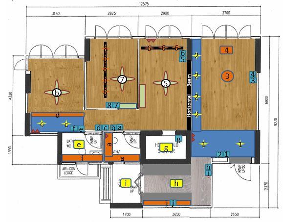

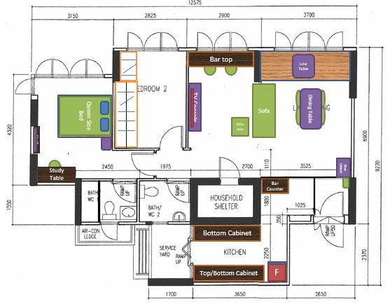

Original floor plan (minus the bedroom wall that we intend to hack):
Space Planning:
Lighting Plan:

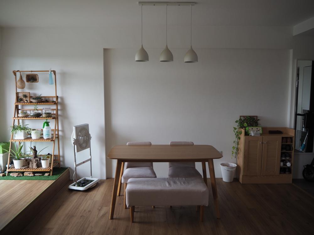

Actual Living Room photos:
That's all for today! Will upload the photos of other parts of the house in the new few posts!

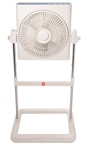

Where did you get your standing fan and what brand it is?
  On 5/13/2017 at 12:22 PM, Labuns said:
Like your floor seats and plant rack. It does look Japanese!
Hi, its KDK standing box fan (Model: SS30H) and i got it from Goh Ah Bee.
Pros:
  1. Design of the fan is not too intrusive and blend in quite well.
  2. Quite easy to move around
  3. Height is adjustable
Cons:
  1. Not easy to clean
  2. The metal bar at the two sides will rust
  3. No swinging motion so not able to cover a large space

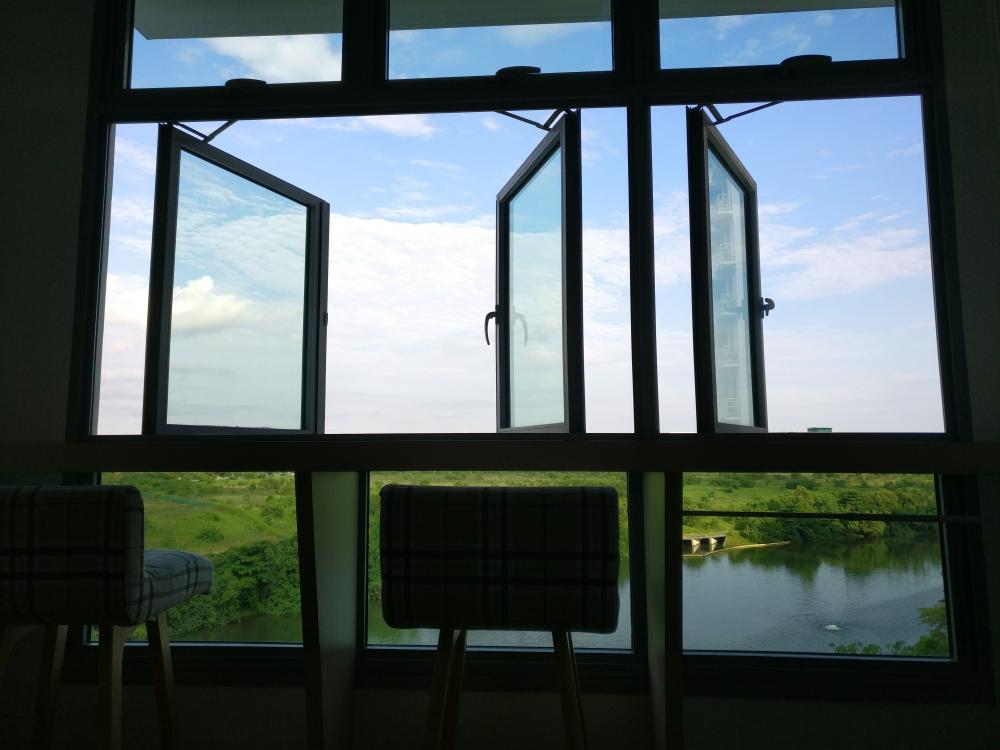

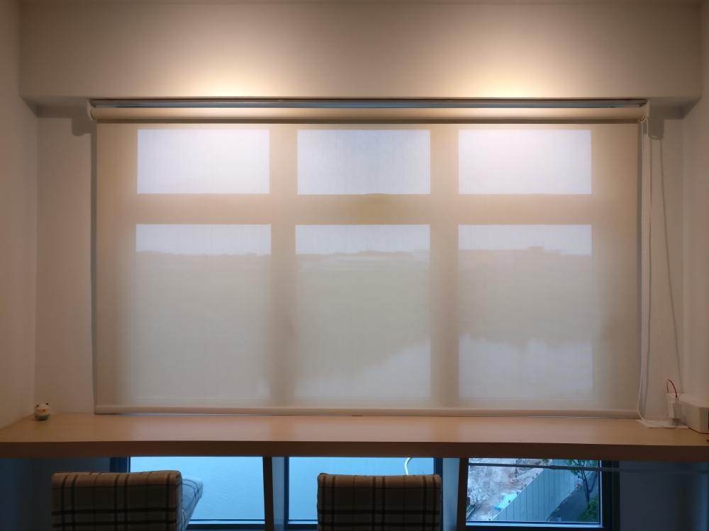

In this post I will talk about the second built in feature of the living room, the bar top along the window. As the living room has an unblock view, we want to make full use of the window area and hope to have the flexibility to sit by the window for meal or using the laptop. the two support in the middle is required as mentioned by our contractor, and instead of doing the support in the middle, i requested him to follow the "windows line" to make it less intrusive. He suggested to make the support shape tapered which is a good idea to prevent knocking into it easily.
On top of the bar top are track lights and we only use 2 x 5 watts LED light to illuminate the area after some trial and error. At the side of the bar top is installed with a 2 gang socket for laptop power supply and phone charger.
The dimension of the bar top is 255cm x 35cm and the height follows the "window line" which is 103cm. Initially we bought two bar chairs which are around 65cm but they are a bit too low, so we bought another two which are around 76cm (30 inch) and they are just nice. Seems like bar chair has standard height too and we got our bar chairs from Tao Bao.
Main problems:
  • It is difficult to open the windows fully because the bar top is in the way (only if you have very long body and hands!)
  • Cleaning of the windows is a challenging task too
