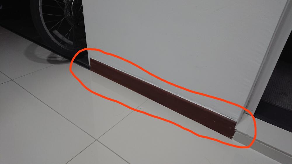

Wooden Skirting (as you can see circled in red in the attached picture) is this panel of wood that HDB
will do as an effort to hide any imperfections between the wall and floor tile. Mine was reddish in colour.
Some other BTOs may have different colour.
I forgot to take it into consideration and should have removed it and replace it with nicer tiles or at least paint it in a black colour
which will better colour match my apartment's black and white theme. I've since gotten used to it tho, so I guess its alright now.

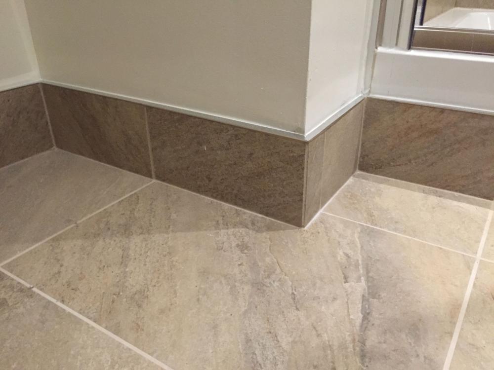

If you opted out of OCS and doing cement screeding, you can do tile skirting like the below example picture
instead of wooden skirting which IMO looks nicer and more resistant to wear and tear compared to wooden
skirting but of course, it will cost more lah.

Good idea about tile skirting. I would consider.
