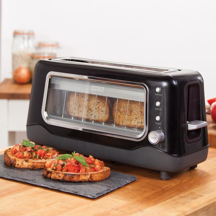

Speaking of voltage issues, just to share, I bought a toaster from Amazon because it looks really interesting! But unlike the Smart Herb Garden, the toaster only works on 110V so I had to get a transformer. When I went Sim Lim Sq to get one, the salesgirl I spoke to asked for the wattage. When I told her the toaster is 1100W, she said the type of transformer I had to get was this ridiculously massive one that can support up to 1500W! And it costs S$189 while the toaster was a measly USD 40. So I just bought a small travel-type transformer (S$23 supposedly 80W) and used it. The toaster was working but smoke came out of the transformer! Siao!
Moral of story: Don't buy toaster from USA!

  On 4/23/2017 at 3:46 AM, ilkl said:
The adapter for the Smart Herb Garden has an inbuilt transformer, the label states voltage range is 110-240V so voltage not an issue. Just need to use a converter.
if you are into buying cheap appliances from USA, then the 1500W transformer would be a good investment since you would be able to use other appliances with the transformer as well.
I had bought a polisher and 750W transformer from amazon which worked well.
of cos, warranty issues will come into play so sometimes better to buy certain appliances locally when there's offer/discounts.
Actually, it is NEVER a good idea to buy a 110V appliance for use in Singapore where the electricity supply is 240V, unless this device is one of a kind which you cannot get in Singapore. If it is a simple non-heating device which consumes little power, a small transformer will suffice. But if it is one with heating like your toaster, you need a transformer that is 2 to 3 times the wattage. This means a ridiculously big, heavy and expensive transformer.
Using an underpowered transformer can cause the transformer to blow up, like in your case. It can cause a fire, so be careful. If you plug your device into the power socket carelessly without the transformer, your toaster will be toast!
Yes, when we smelled the smoke we quickly disconnected everything. The toaster is fine, transformer is not. But we got another toaster from Courts to save the hassle. So we now have a small white elephant sitting at home - 110V toaster which looks nice but cannot be used. Any takers? Shall giveaway especially if someone already has a big transformer at home?
