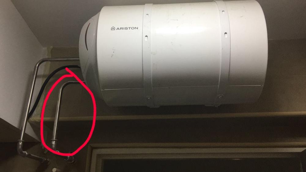

MrandMrs 1 Report post Posted January 1, 2017 On 12/31/2016 at 6:57 AM, LuckyKhoon said: Lets try the following : (recruit 1 family member or friend to help you) Stop usage of all water. Are there still any noise? One of you try standing right below the storage heater, while the other try a) flushing the WC. b) turning on taps. c) turning on showers. Do this area by area to isolate the noise. Check if it comes from within your unit. Ok, I have done the tests. All 3 do not immediately induce the sound. I'm quite certain that the sound is very random, and comes on regardless if the 3 is on or not. Could be my mind playing tricks but the frequency of the sound increases when water is being used. I climbed up and put my hands to the pipe (circled in red). I noticed that before the sound come out, the pipe would vibrate slightly with a soft gurgle. I'm 90% certain that the sound is coming from the pipe of the water tank or the water tank itself. Share this post Link to post Share on other sites
w7_lee 11 Report post Posted January 4, 2017 I thought it sound like a trumpet, so maybe the storage tank is overpressure and the vent valve is releasing the excess pressure. You might want to try switching off the (electricity) water heater after bathing. 1 Share this post Link to post Share on other sites
LuckyKhoon 5 Report post Posted January 5, 2017 The location looks like the where the pressure release valve (or multi function safety valve) is. This could either be the heater releasing pressure or a loose heating element. There is no leaking from the valves at all? You could call Ariston Singapore service hotline @ 6305 0899 for them to check the heater. It could prove to be more cost effective in the long run. Share this post Link to post Share on other sites
