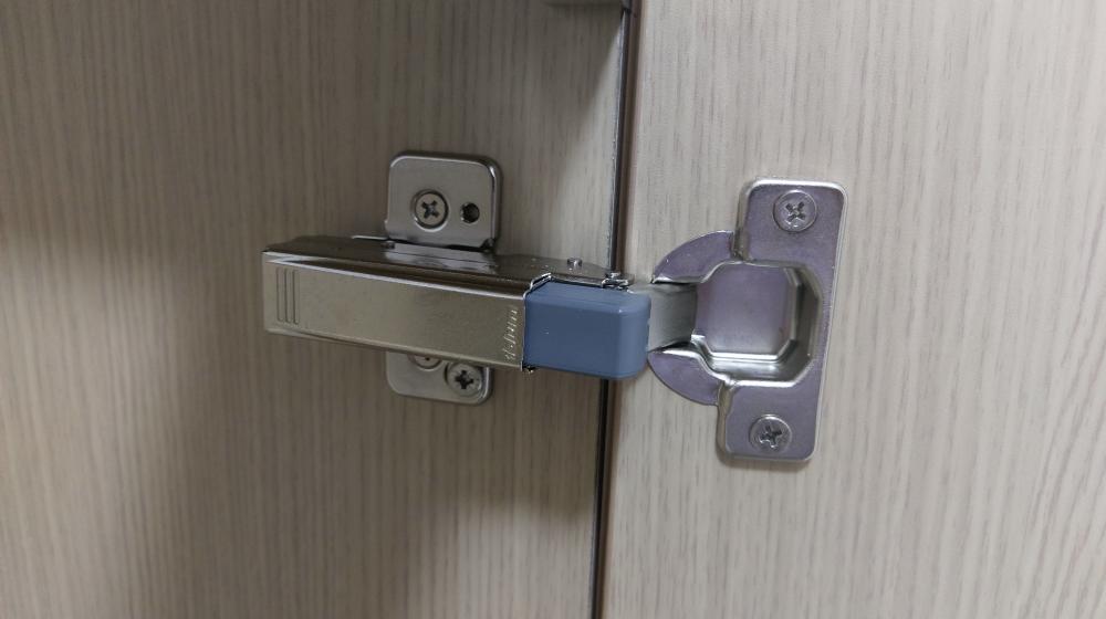

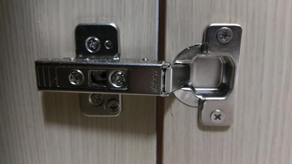

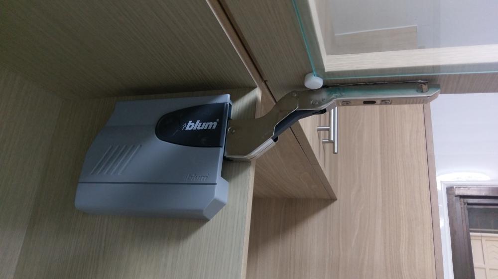

- I got the carpenter to provide BLUM hinges. If you don't like BLUM (Austria), i read that Hettich (German) and Salice (Italy) are also good. However, a word of caution, no matter how good a product you buy, if it is treated roughly or not maintained, the best product will still malfunction. For BLUM, please read <http://connect.blum.com/files/brochure/BRO007_CleaningMaintenanceManual_ZZ.pdf>. Further below i have included the photos of my hinges. Finding out why there are 2 different hinges for the same door. The bigger sized one is for the dish rack.
Update: One hinge is for soft-close. Another is without. Carpenter recommended not to have both soft-closing else the soft-closing will really be stiff when you push it.
