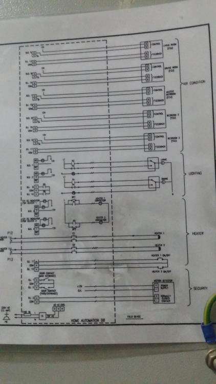

I would be very interested to see a clear wiring diagram on the inside cover of the top box. I am really curious what this is.

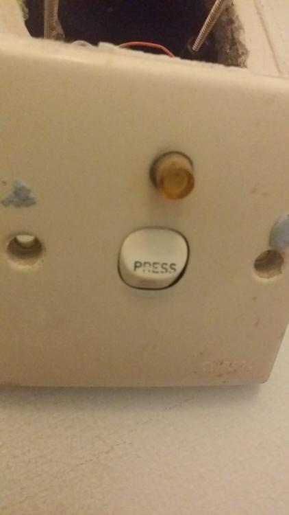

the brand of heater is AO Smith.  I called them a few days ago and they suggested that as the heater is more than 10 years old, I should replace it. However, it is not leaking and is working well. Only thing is the heater switch is the doorbell type switch - you know, the tiny button comes back up after you press and there is a small light to indicate it is on. I asked AO Smith but they said they do not do heater switches. However, this light spoilt a year ago and we have on many occasions left the heater on for a day or so...Tried to get a replacement switch and scoured the hardware shops but was told this type of switch not in the market anymore. True?

Not very sure what is this wiring diagram you are referring to??

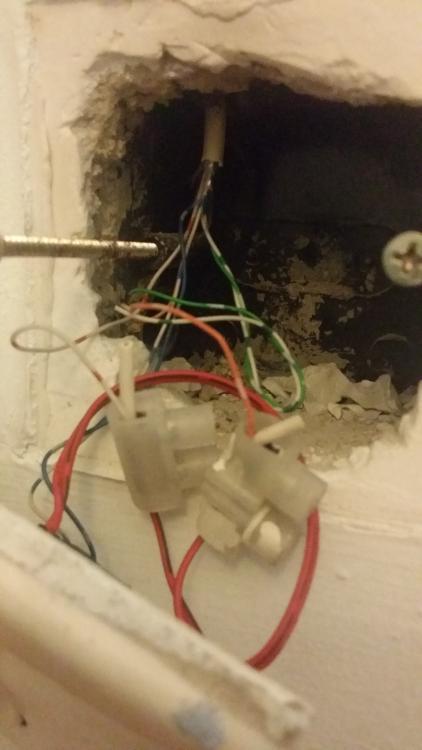

This is what I have behind our circuit board. I don't understand it at all.
I just had a discovery today. The heater switch outside the bathroom is not effective at all. The heater only switches on if I switch on the heater circuit board and will off if I switch the heater circuit board off!! OMG. I'm not sure what the implications are.

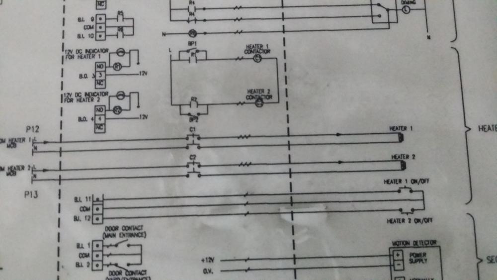

I was referring to the diagram on the inside cover of the upper box. Could you take a clear picture of that. The pictures posted are blurry.
The diagram you posted shows you have home automation, but I noted that the upper box has been unplugged. Is there a reason why it is unplugged. Your home security is no longer in use or is there some other issue?
When you say heater circuit board switch, are you referring the the switches on the lower box; i.e P12 and P13?
Since you say that there is electrical power trip related to heater, it is best you do not turn on P12 and P13 until the root cause has been found. They should be left in the off position and the heater should not be used at this point in time.

20160914_140048.jpg.c7105682ebb54af18290a03a730ee0ca.jpgThanks for comments, Pelect.
We got an electrician to check the wiring. And rectified the heater electrical fault.
Only issue now is to get a replacement heater switch for as the existing switch is spoilt - the doorbell- type switch  works but the light is spoilt. Its Clipsal brand but electrician told me this type is hard to find. Alternative is to change to the standard switch but this means re-wiring and pvc trunking. Sigh!
Please let me know if anyone has seen such a heater switch.
