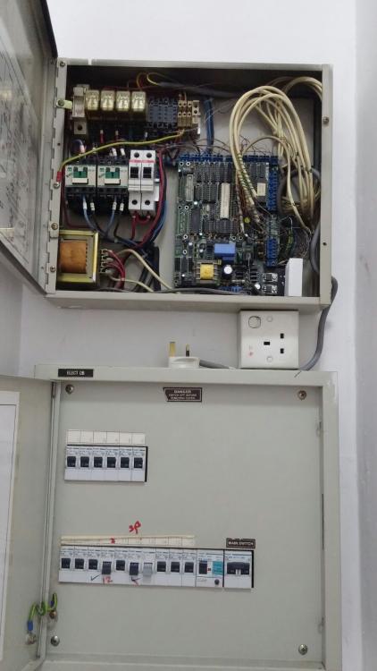

Here is a picture of the heater circuit board.( I am told we are the exceptional condo in Singapore with a separate circuit board for heaters only.  I won't know cos I'm not a technician. )
Since I last posted, I manage to get someone to have a look and he identified that the fuse was spoilt so he replaced it.
Now I can switch on the heater but I have to switch off the main heater circuit board power as well. This was not how it operated before.
We are told that there is a problem with the heater circuit board and the handyman contractor we consulted suggested by-passing the whole heater circuit board and re-wire the heater directly to the main heater circuit board.
Unless we hack the walls, this means HDB type trunk from the 2 heater switches all the way to the storeroom where the circuit board is.
This is ugly but if there is no choice, I am prepared for it.However, I am not sure if this is the only choice? Any views  anyone?
Personally, I would never bypass something without understanding what are its functions.
A storage heater has several safety features, protecting against over temperature, a tank with no water coming in, excessive pressure and safety cutouts.
Personally, I would put safety above all else.
What is the brand of this heater and are you able to contact the manufacturer or dealer?
By the way, please do not touch anything inside the upper box. It seems there are many live wires inside on the left half.
I would be very interested to see a clear wiring diagram on the inside cover of the top box. I am really curious what this is.
