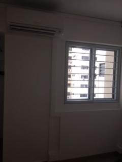

trcd 13 Report post Posted July 31, 2016 How the air con trunking is run in the master bedroom. There will be some obstruction where the bed is, but mostly hidden from view! Kitchen, after all the frantic moments.... 1 Share this post Link to post Share on other sites

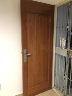

trcd 13 Report post Posted July 31, 2016 Got my main door from Y0ngtat - turned out well! There's only 1.5mm gap between the base of the door and the floor - keeping my fingers crossed that no pests can squeeze in! Share this post Link to post Share on other sites

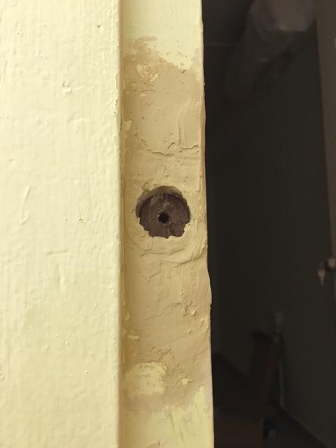

trcd 13 Report post Posted August 31, 2016 workers stained the tiles with some industrial strength glue - and by the time contractor got them to clean it up, it became mission impossible. i was also on my knees rubbing the glue out... look at what the smart worker did. Since cannot close properly, just put TWO metal plates lor. IKR. Share this post Link to post Share on other sites
trcd 13 Report post Posted August 31, 2016 Happy with how the door and gate turned out. Not done through contractor. Share this post Link to post Share on other sites

trcd 13 Report post Posted August 31, 2016 Sanded the surface along the door frame, removed the metal plate from the door jamb and put in wood filler (can be purchased form any hardware store). Apply generously! Let it dry overnight... Sand the area down and if necessary, reapply. Otherwise, good to repaint! I do not have a photo of the finished product as it is not looking very professional, but it is way better than having 2 pieces of metal plates at the door jamb! Share this post Link to post Share on other sites
Catt 8 Report post Posted August 31, 2016 19 minutes ago, trcd said: Happy with how the door and gate turned out. Not done through contractor. Nice door! At least you could change it. Mine is a slanted door frame...there's no fixing that! Share this post Link to post Share on other sites
trcd 13 Report post Posted August 31, 2016 25 minutes ago, Catt said: Nice door! At least you could change it. Mine is a slanted door frame...there's no fixing that! The door is customised to the size of the frame. You can certainly get a new door made to measure, so don't worry! Share this post Link to post Share on other sites

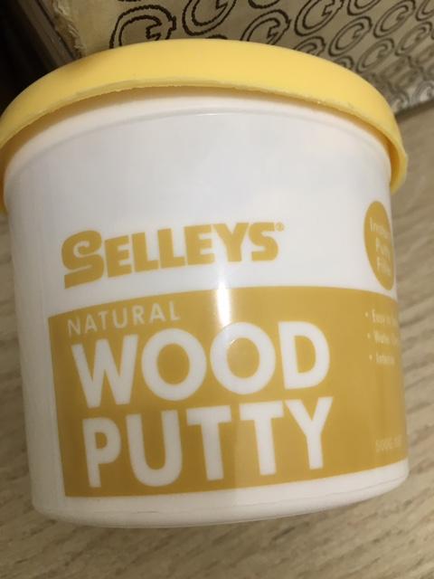

trcd 13 Report post Posted September 4, 2016 What I used: Selleys Wood Putty. It comes with a little plastic spatula/applicator. The texture is somewhat like play dough but slightly rubbery. Here's the finished door frame! And what it looks like when the door is closed. Share this post Link to post Share on other sites
