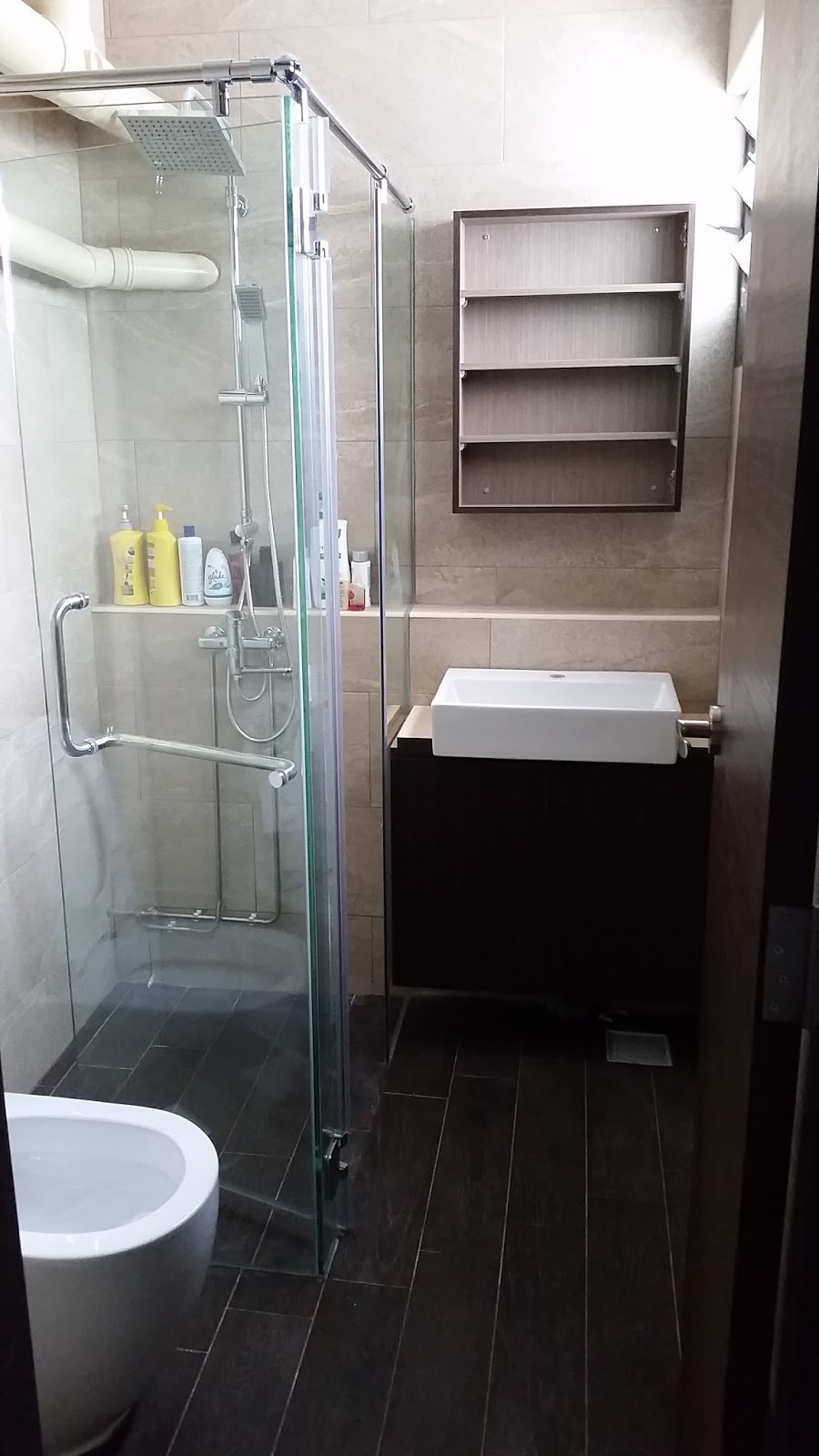

Plumbing Part 2 -- Fixing the basins and pipes
The company that my ID engaged for doing the plumbing work was quite a big company.  So I requested for a different group to come down to fix the issues.
They sent down a guy called Ah Meng, late 30s?  He worked alone and fixed the tilted washbasin in the common toilet.
He also put in valves (mistakenly called them switches) below the washbasins and shower heads.
Something I thought was a standard but then they made you ask for it.
All cold water pipes leading to faucets SHOULD be fitted with a valve.  If not, when you need to change the faucet or when it breaks, you will have to run outside to switch off the main supply to the entire house.
Hot water pipes only requires a single on/off valve next to the exit point on the hot water tank.
At the same time, he also helped to put in the rest of the racks and hooks to the wall.  All went well without a hitch.
A second group came later in the week to change the pipes.
Before
After
Other than just look 'nicer' it also fixed another issue:
Hot water pipes should be at the bottom and on the inside for safety reason.  How do I know this?  The bunch that installed it told me.  And yet, they still installed it with the hot water pipe running 'outside' (see the Before pic).
This second group was also a bunch of young guys but they did a much better job.

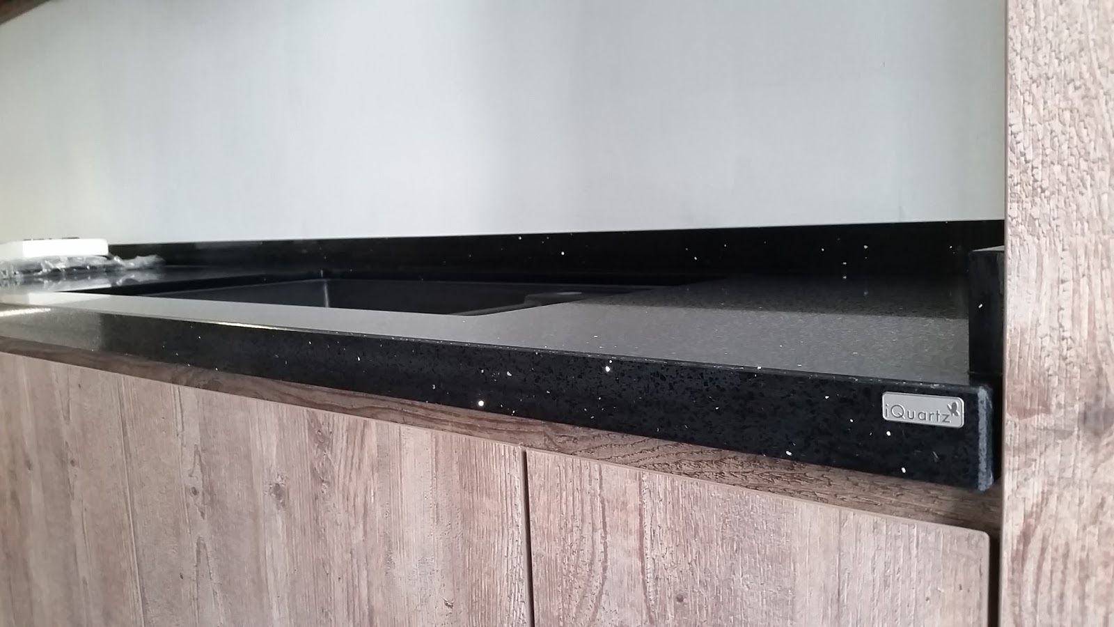

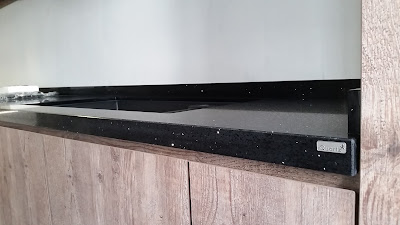

Now that we have used it for three months.  Let's take a look:
Under-mount - for the look and the convenience of pushing whatever leftover on the counter top directly into the sink!
Top view
The quartz top just hovers a little bit over the sink.  This was done so that water would not easily get trapped and stained the silicon seal.  It worked very well and we don't really have to bother much with it.
It's so good to have an experienced carpenter on your side.

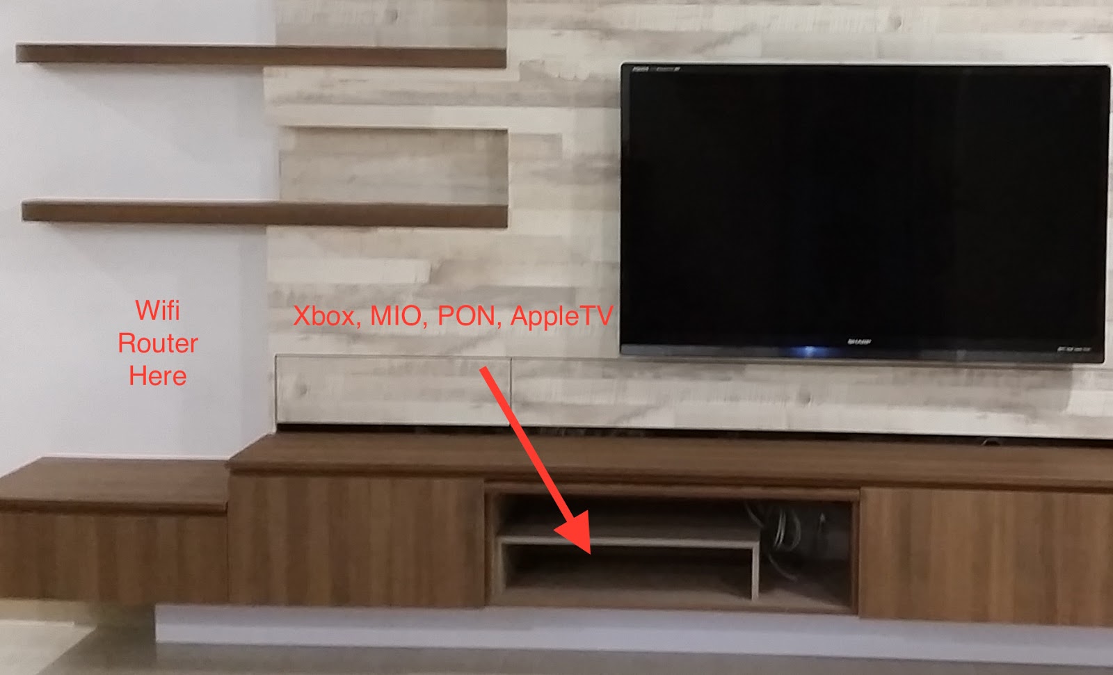

Home Wifi Woes Update 2 - Dual router setup
Left over food for dinner -- ok.
Messy house -- ok.
No lights, no fan in the room -- ok.
Everything is OK as long as wifi is working.
Problem with Wifi Repeaters
I had a Powerline repeater in one bedroom and a wifi repeater on the other.  If you start to move around, your session can easily get dropped.  This is because even when your laptop switches to a stronger repeater, the session will not be handled over.  It may mean you have to reset the connection.  Matter is much worse if you are in between your wifi modem and repeaters.
Internet is not working!
Few days into setting up the repeaters, complains mounted and they simply switched the repeaters off.
One night, after another round of complaints, I decided to make some changes.
Dual router -- one to face SingTel and the other to broadcast wifi
Overkill?  Yep, but doing this actually solved two problems:
1. Keeping the SingTel modem to face the internet makes it easy for SingTel customer service to conduct tests.
2. Keeping the SingTel modem near all my Ethernet connected devices will mean less unsightly cables on the outside.
With the Wifi router outside, dead center of the house, time for another round of test.

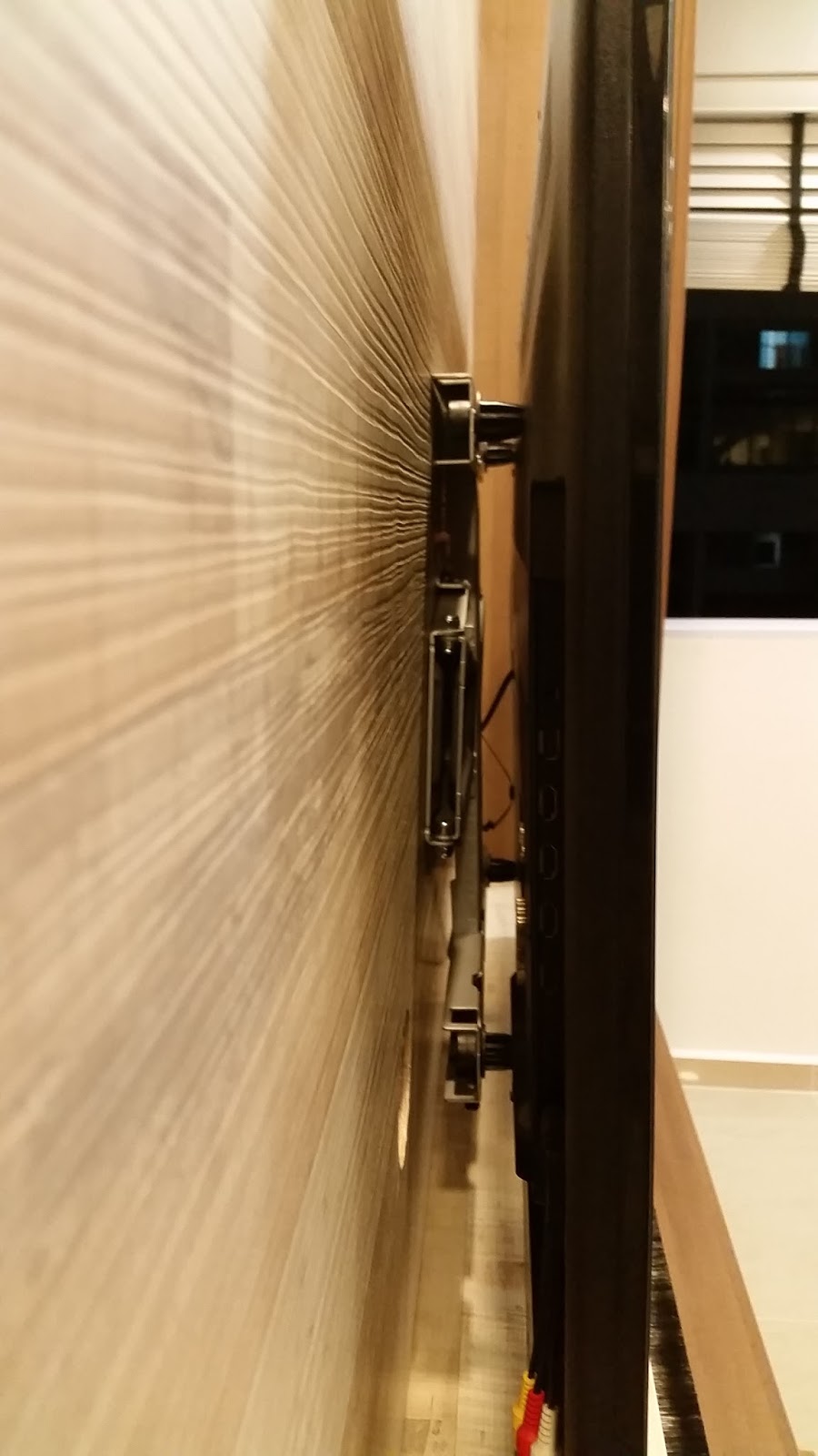

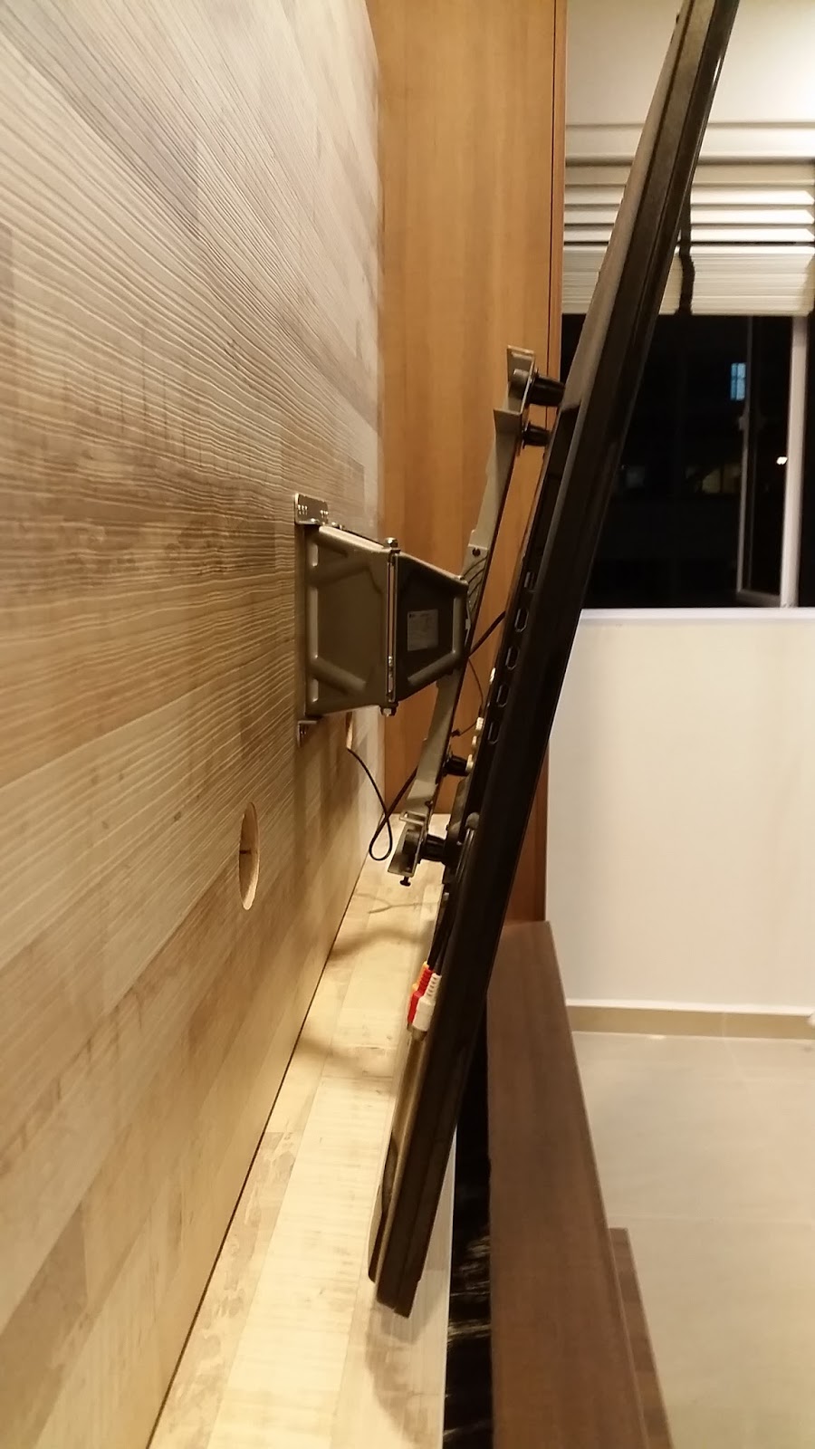

TV Mount -- LG LSW400BG
Three types of mount in the market: Fixed, Tilt and Full Motion
Correspondingly S, M & L -- size of the mount, weight and thickness.
I picked the LG mount because it was exactly what I had wanted:
Slim
And just enough tilting motion up/down and left/right for access and in case there's unwanted reflections.
Mine is a 55inch Sharp.  As long as the TV comes with a Vesa mount, 400x400mm, it should fit.
