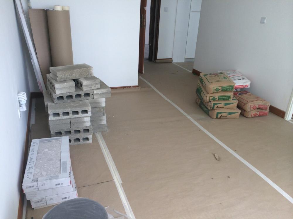

On the first day, materials arrived and protection sheet up.

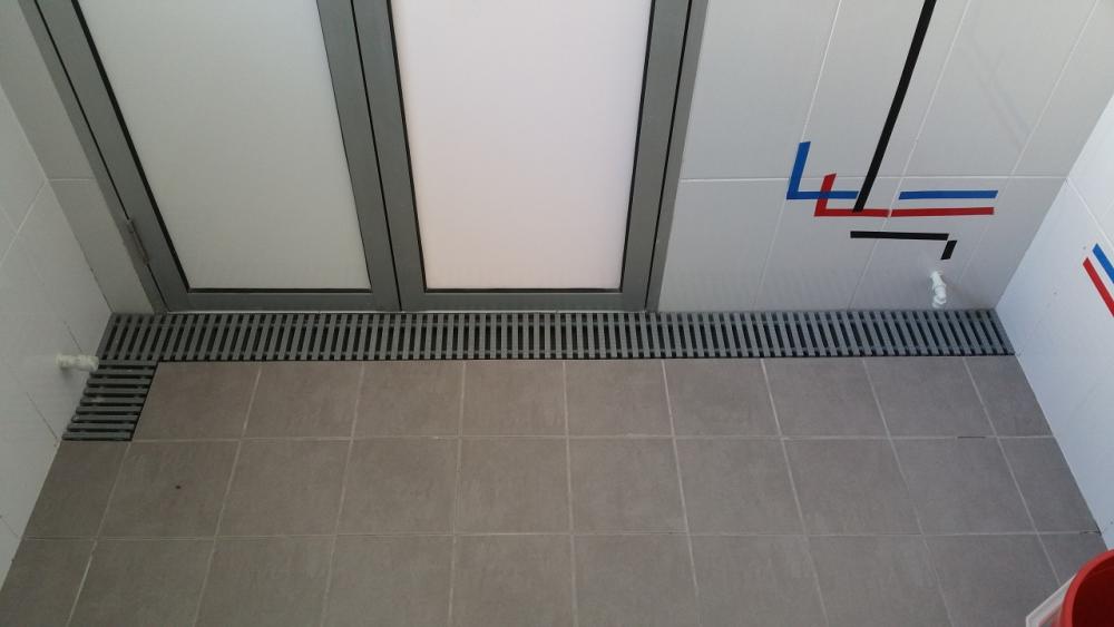

Bedroom side toilet bi-fold door removed. So much damage to the tiles because the door frame is cemented to it. Luckily I reduced door size so patching up and make good the wall is included in the job scope.
Kitchen side bi-fold also removed and entrance size reduced too.

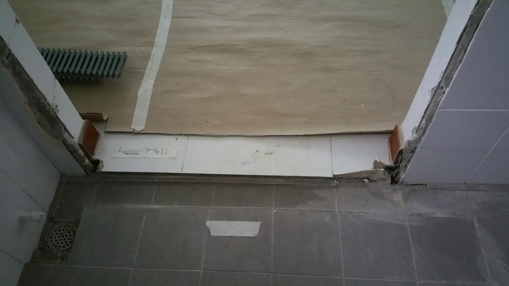

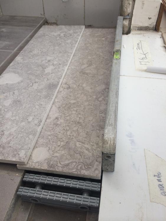

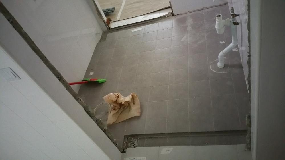

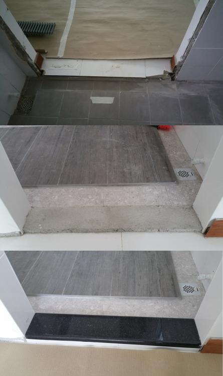

Tiler arrived and suggest to overlay onto the drain cover instead of getting a custom made metal grating, that means the drain will be sealed with cement and cover with floor tiles. This save me money and trouble to get the metal grating which might rust. So I agree to proceed. It was a blessing as later I saw a raised shower platform design and can fit perfectly into my overlaying project. From this picture you can also see how much height is increased after you overlay, it will be higher then my bed room floor, as such I will be doing a granite kerb to both entrance.

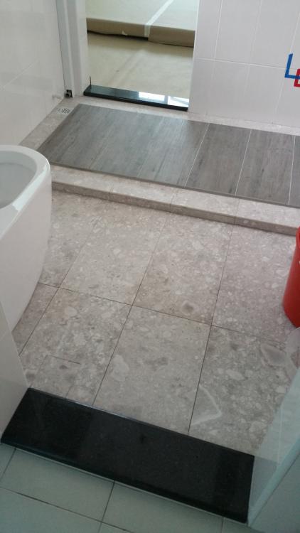

If you seal off the drain opening, where will the water drain off? In my previous place, I had a kerb going into the shower area, and I sometimes trip over it.

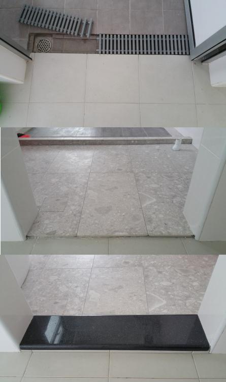

I hope these 2 pictures I posted before give you an idea. Basically the drain is gone and replaced with tiles, my platform shower tiles helps to channel water to the floortrap on the left in the pic. Granite on doorway not installed yet to complete the water channeling.

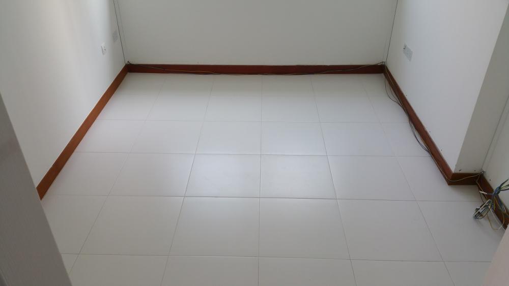

The bedroom where the platform will be installed. Wiring for the lighting is already done as the wires need to be hidden under the platform.

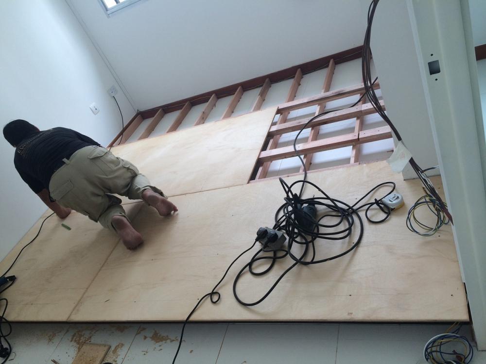

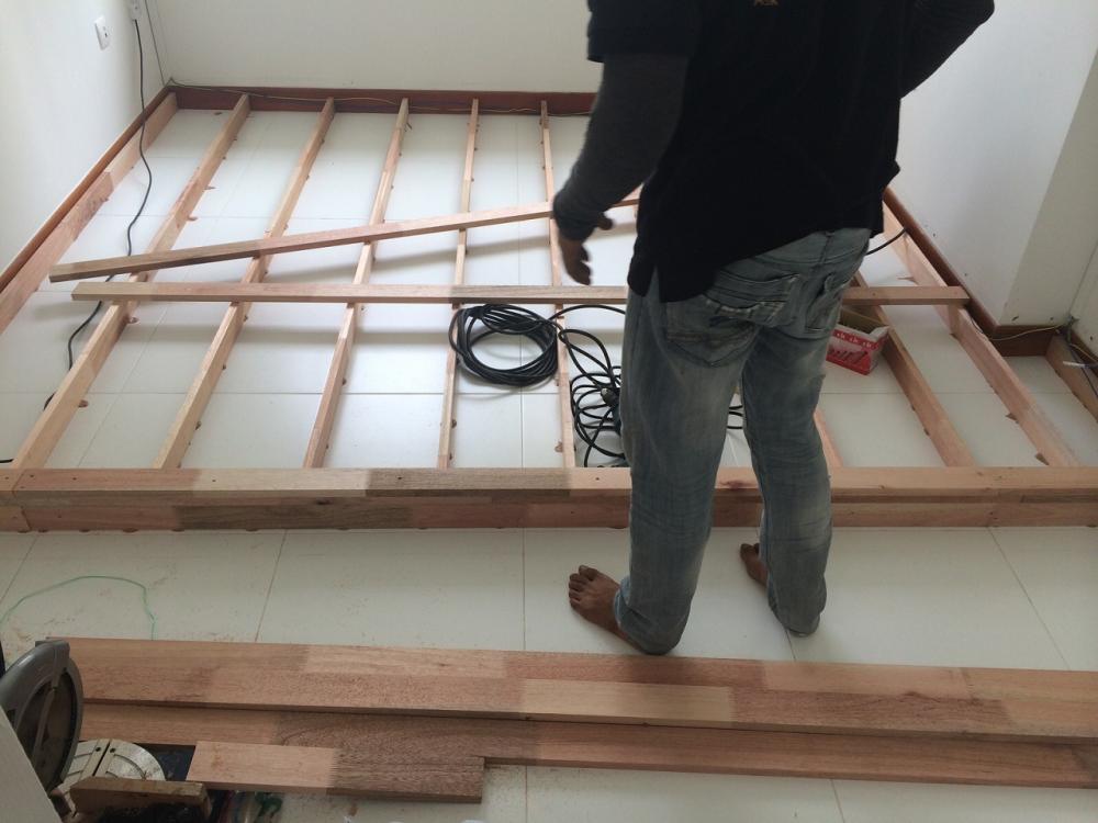

Skeleton work in progress and I am doing a 5 inch platform to cover the wood skirting.
Pelmet for lighting.
Covering it up and laying of HERF next.
And the final product. I tried jumping on it and it is solid like cement floor. No hollow feeling. The HERF itself already very heavy, I tried carrying and omg.....

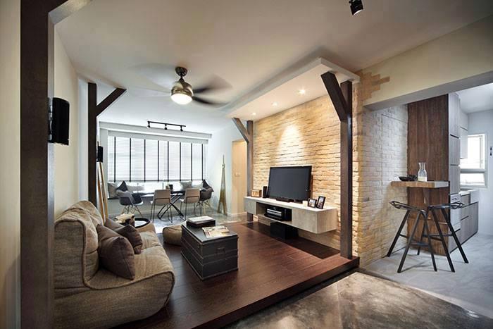

So I am half way there as compared to my mood board.
If you noticed I keep spacing at the bed head to build a pillar to look like this to install my 2 pendant light for Hue bulb.

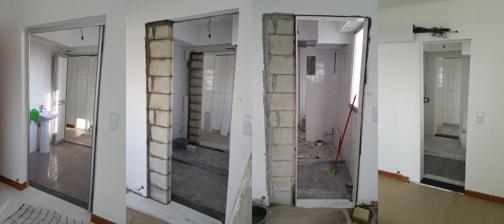

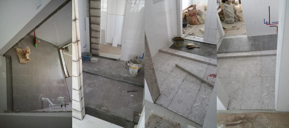

The majority of wet work done is in the toilet as I did not intend to build any cement base in the kitchen, created so much dust due to hacking of wall tiles. I am posting progressive pictures to show the progress step by step just for my own record. I reduced both doors by 30cm, make good all walls to flush. Overlay flooring and made a shower platform.

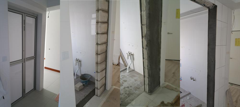

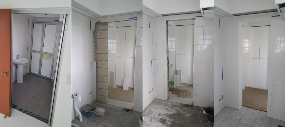

View from master bedroom, extend wall 30cm, make good the wall.
Same door but view from inside the toilet. The extended wall give me more shower area else will be splashing water on the door if never extend.
View from kitchen toilet entrance. Also extend wall 30cm and this wall is thicker.
View from toilet for kitchen side. Extend this wall so that I can make a 40cm depth vanity top.

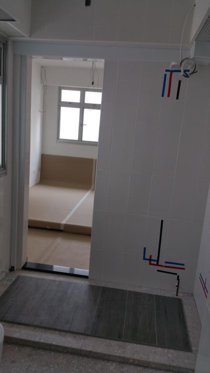

Flooring as overlayed with shower screen kerb and platform shower.
Bedroom side entrance, made a granite kerb to complete the water channeling for the platform. Use floor trap in the picture to imagine as camera angle is different.
The same to the kitchen side, ugly plastic cover is gone, now with a camouflage floor trap. The main floor trap is beside WC so this camouflage one is just redundant. It can be opened with a scraper.

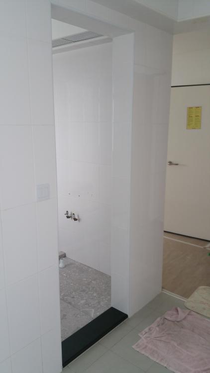

This is the current state of kitchen side entrance pending glass door installation. I yet to decide to swing in or swing out for the door.

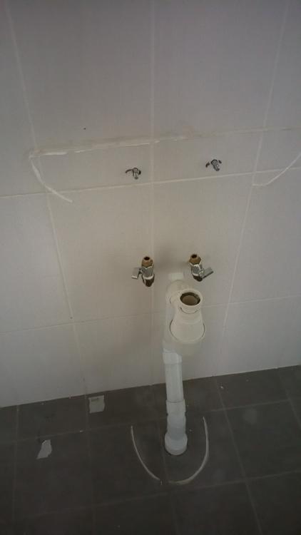

Current state of bathroom pending heater and fixture installation. Aircon trucking is installed and it is a tight squeeze. I didn't expect trucking to be so big and luckily it managed to fit right into the space. It does protrude out a little at the doorway but there is a door frame to be installed so will not affect door from swing in. Learned my lesson that next time must pre-plan all aircon trucking route especially the drainage pipe.
Been walking on this tile while doing some cleaning and totally loving the dry feel.
Pending carpentry work for vanity to complete the toilet. I am happy with the way the toilet is now. Better then I expected.
