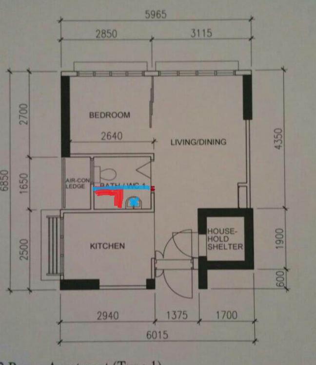

Rufus, I think the best design is to put a L-shaped shower screen. But u need to measure the actual area to get the measurement. Standard I think 90 x 90 but can be done 80 x 90. Try to extend the max til the window area. As long as there is wall will do. The basin can be reposition towards the wall to give more space for the shower screen. But then I think your concern is towards the WC side... You can ask ur ID if there is any sample of 80cm width shower screen for you to have a feel of the width.
If you insist on the blue line, what you need to do is 1) reposition the basin to perpendicular wall 2) remove the bi-fold door 3) reduce the width of the bathroom door by extending the wall 4) buy a new bathroom door.
This will make your wet area similar with mine, ie. having the basin inside the wet area.
Hi Rufus,
For your L shaped shower screen, I assume it will be resting on a L shaped curb.
Please do also take into consideration of the location of the floor trap in your toilet and how the water is flowed towards the floor trap.
You don really want the water to be trapped at the corner of the L shaped which you need to "physically" clear/sweep the water to the floor trap, which happens to me. :wacko:

20 hours ago, RuFus58 said:
Hi all, i am very sad... my toilet vision is not going well..
last wk meet up with my frend (ID), she proposed my L shower (in red) will be 75cm x 90cm... omg!!!! how miserable is that??? T_T
so i said, why cannot be like this (in blue), and shift the basin... so i have whole rectangle as wet area.. apparently the wall is not enough, (the brown dot)
she say the lousy position of the toilet bowl makes it hard to play ard with the shower area.
i dont' want to hack the wall in the kitchen to make the toilet door and deprive myself the kitchen cabinet...  or hack bed room side to deprive my cupboard wall.
what to you folks think?

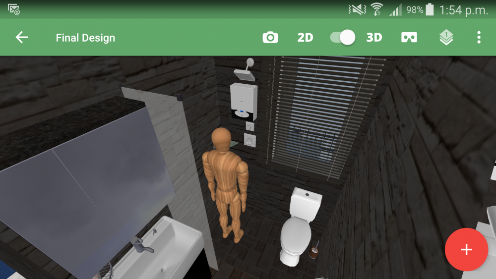

My apartment is exactly the same as yours. If you've seen my 3D design in 5D planner, my Toilet is vertically divided in half instead of your horizontal to accommodate for wet and dry area.
(Wet area is lower consists of shower area and toilet bowl / Dry area is raised higher consists of the sink)
To prevent water splashing the sink with my future vanity mirror, I put a plane of glass. Below is how it is. Jus imagine the wet area is abit lower.
Screenshot_2017-05-23-13-54-43.png.2c12cb6b52e28a1376a8c8e0a9cedfa9.png.2d8369f39e0a12c570c6568185b8b338.png

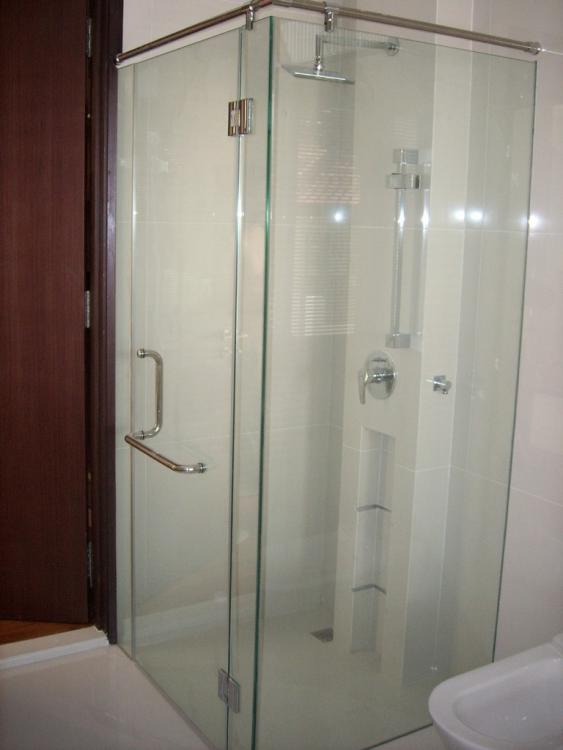

Anyway, whichever u go for, I highly dun recommend putting a box up shower screen like the below pic if you are thinking of doing it.
I have a friend who did that and it was a tremendous hassle to clean. If dun clean often as time goes by easily grow mold and algae within the nooks and crevices very disgusting.
There is also a tendency sometimes when showering accidentally knock the shower head against the glass panel.
Also, toilet itself already small, why enclose yourself even more in a small glass box?

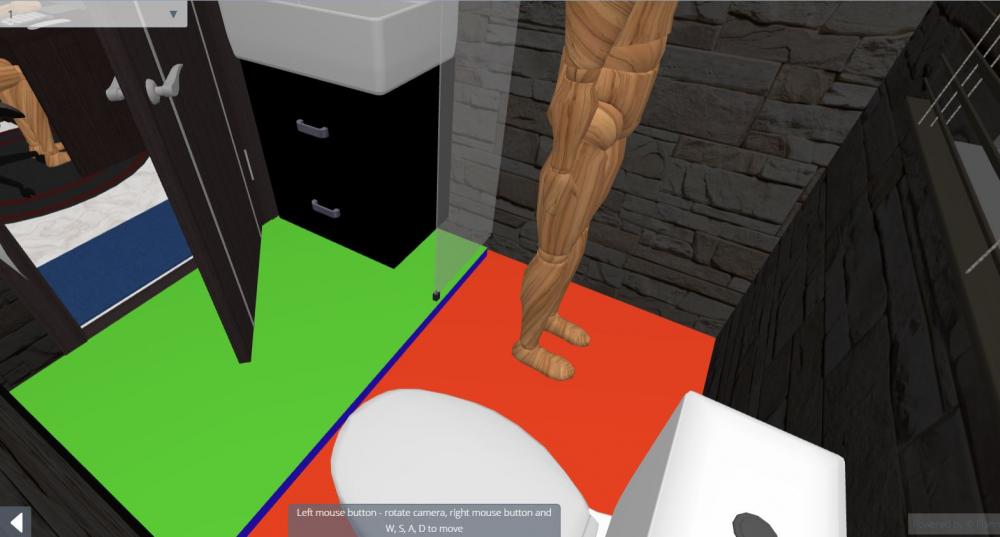

Actually yes I do want to split my wet and dry area.
My wet area will be actually lower then my dry area and to reach it u need to do a small step down.
This is my way of keeping water in wet area never able to reach the dry area when i shower.
Here is what I mean: (I amended the textures and changed the colours to make it slightly easier to see)
Green area is my Dry Area and this is a slightly raised platform. (maybe about 1 inch or so in height)
Red area is my Wet Area which is slightly lower in order to trap the water to be able to drain away when I shower.
The small little blue between them is the height difference between the 2 areas.
Hope this clarifies better.
