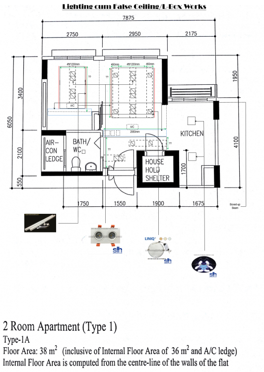

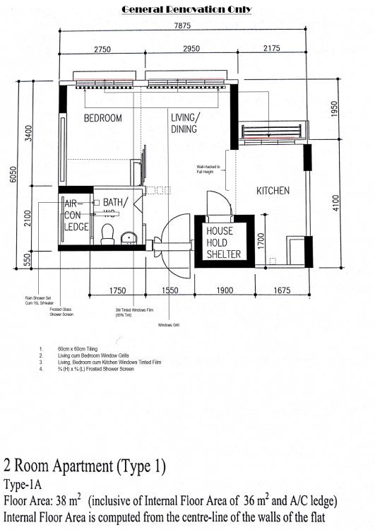

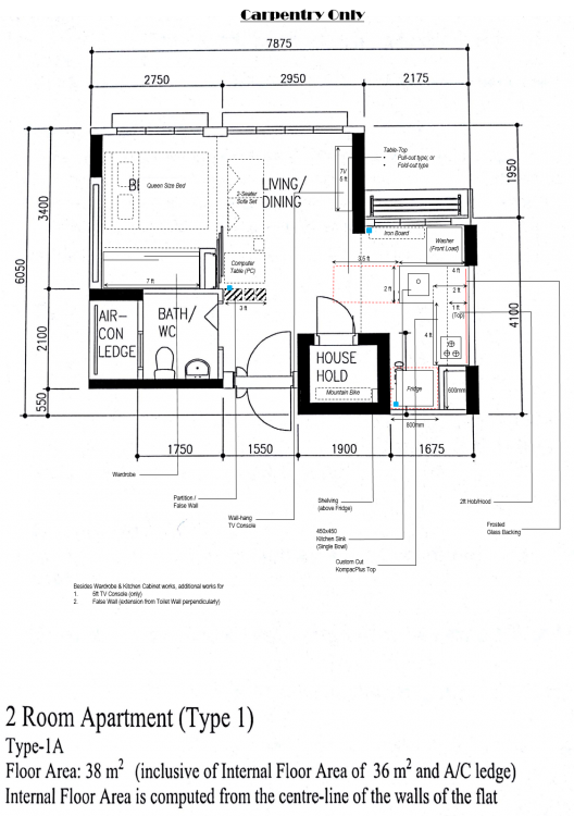

Any better idea besides my sketch-up?
  • Pic #1: General Renovation Works
  • Pic #2: Ceiling & Lighting Works, and
  • Pic #3: Carpentry Works
hi, I think you got quite an interesting layout here.
Living room - instead of partition wall, you can actually do a full height shoe cabinet. if your intention is also for privacy, then that shoe cabinet should serve the purpose.  Note that there is casement door in the DB cabinet so if you put your computer table there, it might block the door.
Kitchen - I suspect you might need to switch your fridge and washing machine location. Cos my washing machine drainage pipe is located right beside the rectangle where all the pipes goes to. At first glance on your layout, I think this layout suits a bar counter type of kitchen, at the place where kitchen and living room connects. This will probably gives you the dining area but you will not be able to do the L-shaped cabinet with sink liao. If you do not plan to have door for kitchen then maybe you can consider bar top / dining table at that location.

HaHa. Don't tell me the foyer area is where my common toilet housed! Not only you comment it; other IDs I visited during my reno shopping too finds it weird.

that yes, but also the layout. cos if u see all our floor plan, mostly are squarish with kitchen bathroom and bedroom on 1 side and living room taking the other side. whereas yours sort of space it out with kitchen at the other side of the living room. your layout is the only one so far that has potential for a bar top counter.
