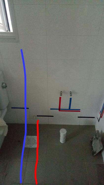

I have the toilet layout with 2 doors and am having great headache, look like you have changed the basin area into shower area? Do you have more photos to share please? Can we get rid of the false ceiling?
Yes, i have replaced original basin area wif shower and move basin to the other side in order to create wet/dry. And i have overlay original shower wall tile to cover up hot/cold water outlet.
Also, my wet area is abit narrow (70cm width) due to the position of the floor trap. As shown in the photo, my shower kerb can only be built at red line area. Blue line area would overlap with windows. Floor trap cannot be moved unless u want to void hdb 5yrs warranty.
Dun think it's advisable to remove false ceiling as i think the pipes are conceal inside the false ceilings.

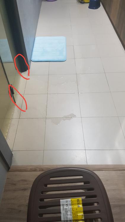

As you have moved the shower area next to kitchen bathroom entrance, you may need to consider about water leakage from that entrance when you shower.
When i first moved in, my kitchen is always flooded after i've showered. Not sure whether hdb bathroom door is diff as i have changed the bathroom doors to frosted glass bi-folding. The situation had improved after the door ppl to fix it but my kitchen floor is still wet sometimes if i'm not careful when showering... :(
Water leakage as shown in pic before fixing. Red circle is source of water leakage.

Not true leh..  my bathroom sliding is the same as shown in the pic with fixed panel on right side and sliding on left side. I don't have any water leakage problem on that side.

9 hours ago, Ankle said:
@lindatok and @CaseBlue,
Thanks @Ankle for the info.
Is the leak because your kerb too low? cos I can't really see the kerb from the photo...
Mine also got water seep to the kitchen every time... >_<
I didn't built shower kerb at the entrance. Dun think there's space coz wet area quite narrow.

Note: I retained both two toilet entrances instead of sealing one, for some reasons. Yes water sometimes seeped into kitchen floor during shower. Not often though.
