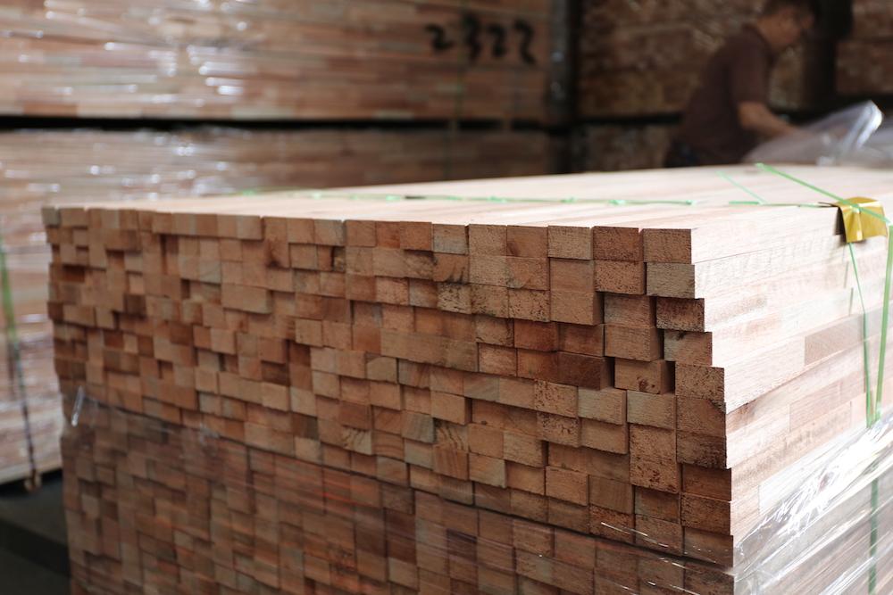

I'm from U-Court Wood Products, the specialised wholesaler and supplier for Nyatoh Timber Wood, Reconstituted Veneer Plywood, Meranti Finger Joints, S4S Sawn Timber etc to businesses, merchants, retailers and carpenters. Hopefully some of the pointers are proven useful! You can also look us up at www.ucourtwood.com if you require any supply of timber wood. U-Court Wood Nyatoh Wood Supplier.JPG
