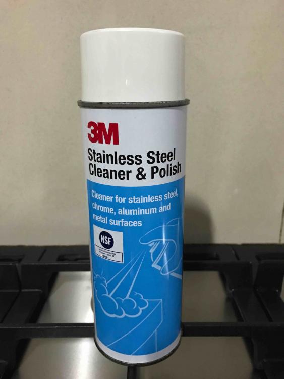

MLTR 0 Report post Posted March 17, 2017 Hi KS, to me, you are very good in DIY stuff. May I ask you what would you do/use to effectively polish surfaces (e.g. shower bar, bathroom accessories such as towel hook etc.) that have lost its shine over time? Thank you so much in advance! Share this post Link to post Share on other sites
kstoh 3 Report post Posted March 17, 2017 Not really. Just that I know a little and I believe most homeowners should know the basics. Normally, we just use a microfibre cloth to polish it a little. But if it is really bad, you can try 3M Stainless Steel Cleaner & Polish. The instructions say it is good for chrome surfaces too but I suggest you try out on an obscure area first. Share this post Link to post Share on other sites
MLTR 0 Report post Posted March 17, 2017 Thank you very much KS. Will go to the hardware store to hunt for this. Share this post Link to post Share on other sites

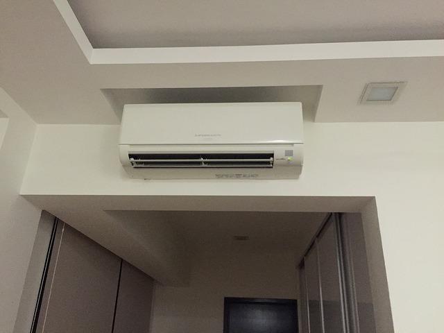

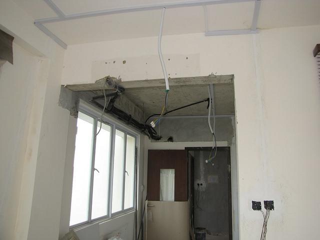

El LoCo 3 Report post Posted March 18, 2017 Hi KS, can u pls review yr aircon and how u hide the trunking by the way? Any reason why do u not choose the ducted aircon? Share this post Link to post Share on other sites
kstoh 3 Report post Posted March 18, 2017 2 hours ago, El LoCo said: Hi KS, can u pls review yr aircon and how u hide the trunking by the way? Any reason why do u not choose the ducted aircon? I am very happy with my Mitsubishi Electric split unit aircon. So far no problems. Quiet too. Compared to the Toshiba units at my previous place. All my trunking are hidden from view. For my downstair aircon units, the fancoil units are mounted on the house wall. The trunking punches directly out and runs on the outside of my house along and above the aircon ledge. For all other rooms, the fancoil units are mounted on the wall between room/toilet. The toilets have false ceilings. The trunking punches through into the false ceiling of the toilet. For my master bedroom, there is a wardrobe passageway before the toilet. So the trunking needs to run some distance from fancoil unit to toilet false ceiling. Probably, it is easier to explain by showing you pictures. Share this post Link to post Share on other sites
kstoh 3 Report post Posted March 18, 2017 I did not choose ducted aircon for several reasons:- 1. I am not familiar with ducted aircon. My impression is that it is going to be almost impossible to clean the ducts. Some time ago, I heard of horror stories about aircon ducts in commercial buildings. Apparently, you can find dead rats etc. inside, because it is almost impossible to clean them. But I have no idea whether this is true or not. How does one clean the ducts? 2. You need to run ducts everywhere, and this lowers the ceiling. For example, if I had to run ducted aircon to my master bedroom, the ceiling of the entire passageway for my master bedroom would likely be lower by at least one foot. In my previous condo unit, there was ducted aircon everywhere installed by the developer. I removed all the ducts and installed split units. When I was selling the place, several buyers asked me why my place looked bigger than other units of the same configuration. The difference actually was that my ceiling was higher due to removal of all the ducts. 3. I believe ducted aircon system will be more expensive, but I am not sure. 4. I assume for ducted aircon, one compressor will serve all the blower units? What happens if the compressor breaks down? I like one to one split aircon units. When one unit breaks down, I can use another room. Share this post Link to post Share on other sites

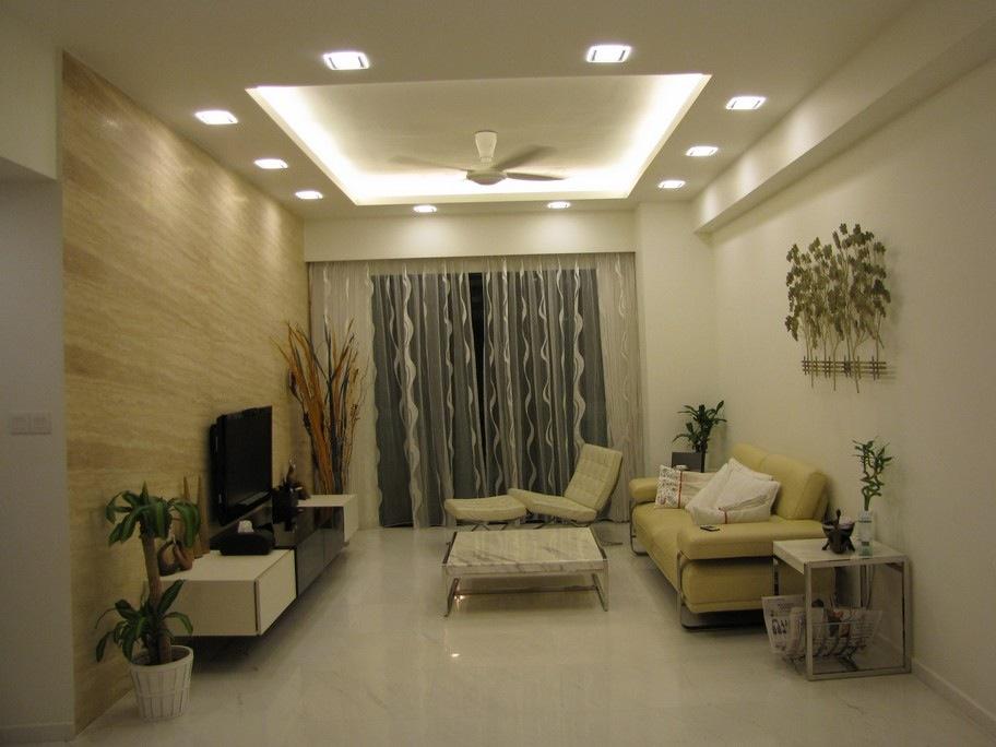

runmyhousehold 0 Report post Posted March 18, 2017 Hi again! How did you plan where to place your recessed lighting? Share this post Link to post Share on other sites

kstoh 3 Report post Posted March 19, 2017 (edited) On 3/18/2017 at 11:06 PM, runmyhousehold said: Hi again! How did you plan where to place your recessed lighting? I had several considerations: 1. Ceiling to be as high as possible 2. Downlights (recessed) for lighting 3. Cove lights for ambience (but in practice I seldom use) 4. Ceiling fan (against ID's wishes) For my previous and current place, the recessed light are all pushed to the sides. If possible, all 4 sides. But most rooms, only 3 sides or 2 sides (L shape) as not big enough for all 4 sides. I try to put the ceiling fan in the centre. I show you as an example, the layout in my previous place. Edited March 20, 2017 by kstoh Share this post Link to post Share on other sites
runmyhousehold 0 Report post Posted March 19, 2017 Thank you so much! So is it safe for me to say that cove lighting is really not very necessary? The reason why I ask is that I'm thinking that without cove lighting I can get rid of an extra horizontal surface to clean. heh. Share this post Link to post Share on other sites

kstoh 3 Report post Posted March 20, 2017 (edited) On 3/19/2017 at 10:02 PM, runmyhousehold said: Thank you so much! So is it safe for me to say that cove lighting is really not very necessary? The reason why I ask is that I'm thinking that without cove lighting I can get rid of an extra horizontal surface to clean. heh. I guess it depends on your individual preferences. Cove lighting is normally "warm" lighting for ambience. Downlights and other lights are mainly while light for lighting up the place. Although I always install cove lighting, I find that I rarely use. It is always down lights on (room bright) or off (no lights). So if you are like me, cove lighting is not really necessary. And yes, you will get rid of this ledge where dust can gather. Come to think of it, I have yet to clean for many years. And if you are able to get lower profile downlights, the false ceiling can be higher, resulting in an higher overall ceiling. BACK TO TABLE OF CONTENTS Edited October 21, 2018 by kstoh Share this post Link to post Share on other sites
