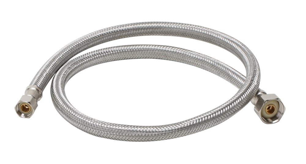

I managed to replace the water outlet with the following items so as i can install and use the 3M under sink filtrate system.
Faucet Connector, Braided Stainless Steel - 3/8" Female Compression Thread x 1/2" I.P. Female Straight Thread
http://ecx.images-amazon.com/images/I/51GSRAa2Y8L._SL1500_.jpg
This is the image of the required or supplied faucet connector. NOTE the both ends of the hose. The larger one is 1/2" which is commonly used here. Length is entirely up to you, you can choose a shorter one if you need.

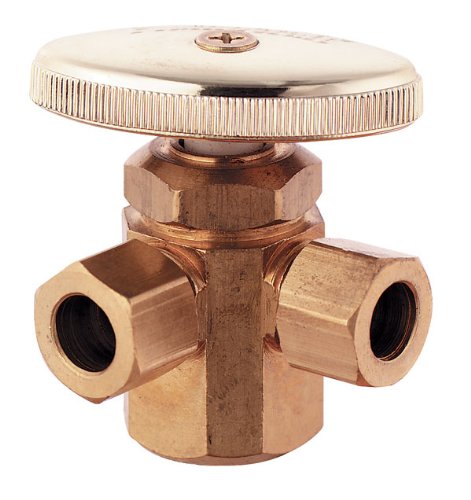

And from the water outlet, you will need this:
3/8-Inch by 3/8-Inch by 1/2-Inch Low Lead 3-Way Valve
http://ecx.images-amazon.com/images/I/51QFxSgE4QL.jpg
Regarding this, Delta faucet has two levers, so you ll need two faucet connectors, and a 3 Way Valve. Just like what the picture has shown.
