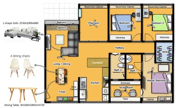

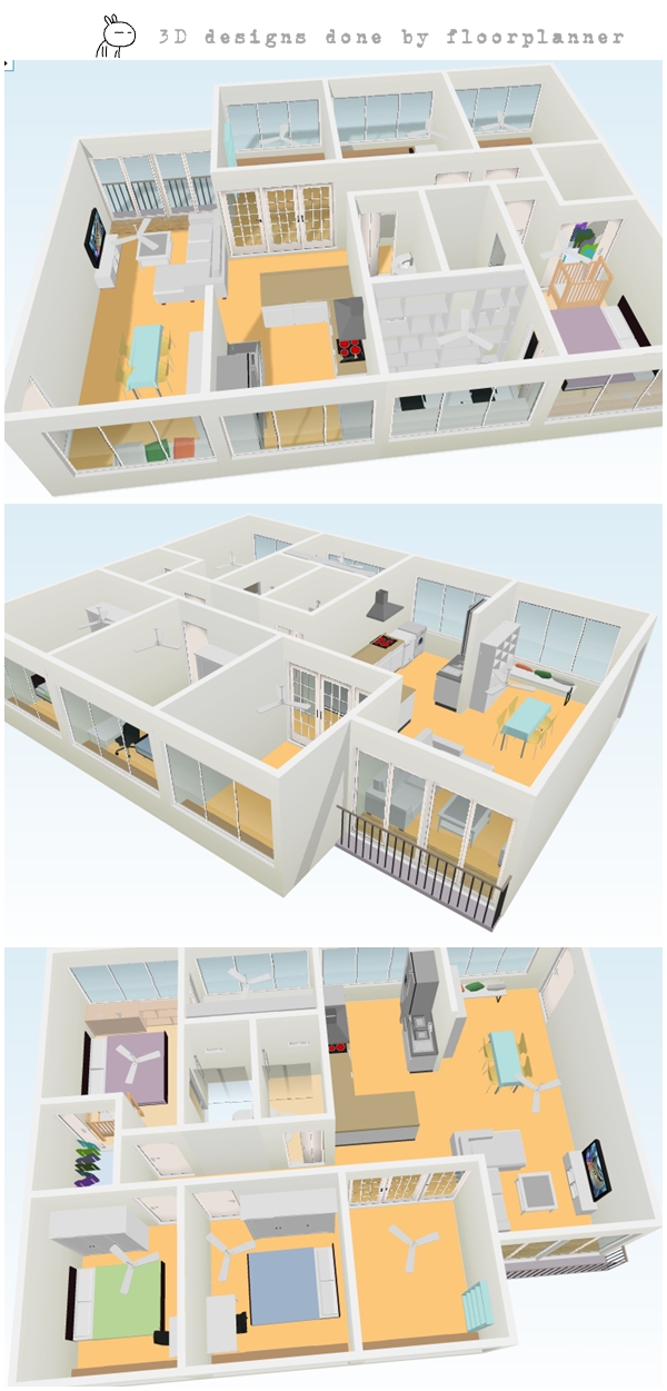

Used the floorplanner to draw the floorplan and 3D design, also indicated the place to put the furnitures we bought :
Took about 2 hours to draw this, not too bad huh :P :

Wow, very impressive drawing, I'll explore the idea of keeping the existing balcony to make it as a planter, I'll hack away my current marble and use timber strip or ceramic tiles with wood grains to lay the floor. My FSM said must put a water feature at the corner so I think it's better to make it as outdoor rather than putting the water feature in the hall, what do u think? My only concern is my hall is very small, if i put back the balcony, my sofa have to place at the middle of the hall way..
by the way, from your drawing, I noticed your balcony is only 400mm, it's rather narrow right? I think 500mm or 600mm will be better for a human to stand there. And, have you spoken to contractor about adding the sliding door at balcony? Your reno is quite major, a lot of hacking, how can you still keep it at $50k, I wish I can do as much as yours with the same budget as well, but seems like most ID telling me my budget too low...

Thanks barcadibreezer ... hehe.
I like tiles with wood grains too, but will keep as existing parquet flooring due to budget constraint. Since your FSM asked that, you can really think of keep the existing balcony as planter .. For us, we only keep about 400mm for balcony due to space constraint too .. you can notice that half of our sofa is already shift to hallway area. Since the sliding door will be opened when we stand at the balcony, i.e. the space allowance will be much more than 400mm (400mm is only when the sliding door is closed), so I think shall be ok. We can also sit on the platform and enjoy the outdoor scenary at balcony while open the sliding door. Of course, we also hope to get a bigger balcony but there is constraint in existing layout : (
Yeah, we have informed all our ID/ contractors with the new modified layout (with sliding door and balcony) and also received their quotations ... but we haven't finalized on the shortlisting of ID/ contractor. $50K is really tough for us as well, initially thought just need $40K ... Hope we really able to keep below $50K, or will not be exceed by too much.
