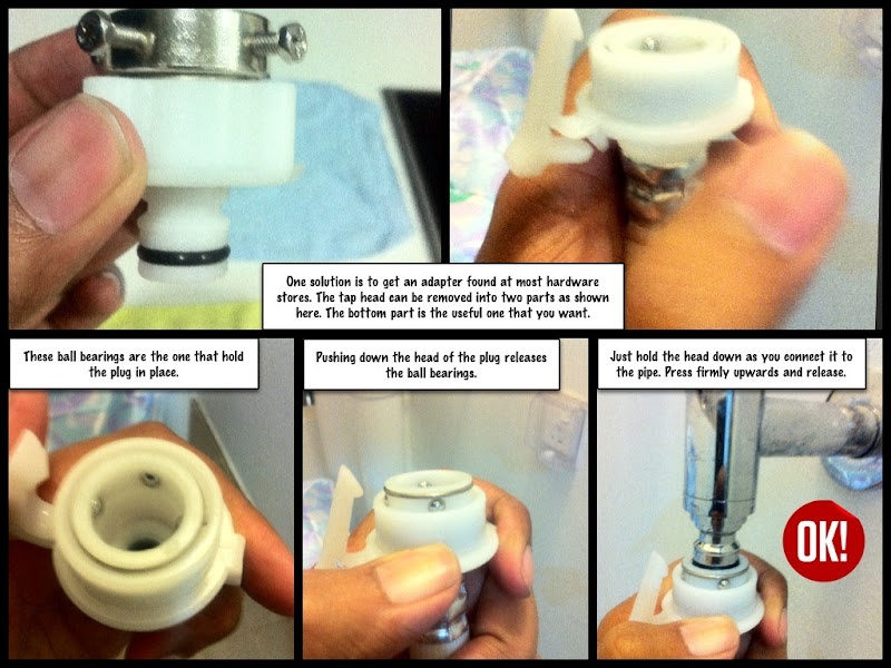

I wonder if this service yard tap is unique to my estate only. Thought I'd share how to shop for the adapter for front load washers to connect to this particular type of tap.

hmmm... this is interesting...
haha, thats a very clear illustration =D

Cs, ww >>yeah searched high and low, talked to so many uncles in hardware shops, bought many pipe connectors that didn't work. So I thought I'd save others the trouble I went through. Glad I found that one uncle who understood my needs though.

Sorry to hear about the trouble you went through with the tap adaptors... if only I had paid attention to your blog earlier I would have saved you a lot of trouble cuz I could have told you to get exactly what you needed.
