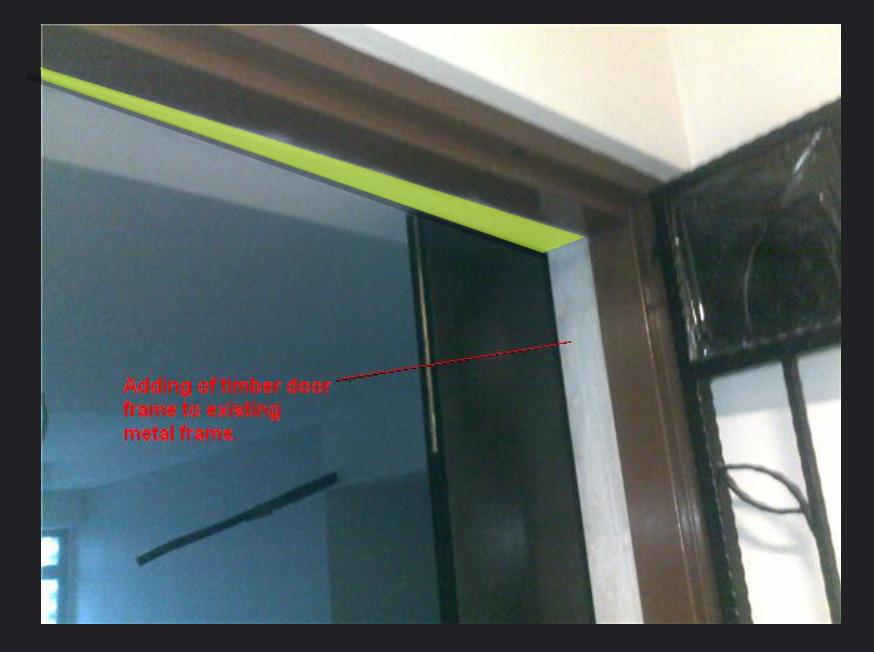

its not so complicated as all of u r saying...i only adjust my door, gate no adjustment
The additional of timber frame (as shown painted in white) to existing metal frame in order for the door to tilt.
- HDB has already approved
- Shown master chang the pix, informed by him that it is gd.
*pls note that the gap between the 2 frames must be filled by silicon and the additional frame must be painted the same colour as the existing frame.
Hi, hardly can see clearly on your photo. Is your added frame angle (yellow part) like this?
TIA
