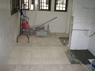

Kitchen - Missing Patch
We hacked away the previous half-height wall. And we couldn't find the similar tiles for its size (33x33). So, I decided to get a similar tiles with different size (30x30). Hence, the different grouting. Most probably, we'll cover it with some rug.

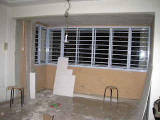

Living Room - New Grills
We love the new window grills.

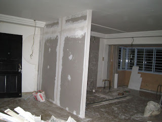

Living Room Partition
The living room partition is up. Strangely, the house "feels" better once the partition is up. Effect of fengshui or self-fulfilling prophecy ? :P
Anyway, I want to change the door color to lighter brown, totally dislike the current brown black color (you can see in the background from the picture above). But if we paint the door, it won't be nice. Anyone has a suggestion for this?
Nope ... just simple and practical with budget in mind :D
Hope all would turn nice.
  gimz63251073 said:
nice grilles! :) btw, any theme for the house?
Did you ask the contractor to redo the mismatch tile?
I dont think it will cost a lot,
since it was only couple meter2 only.
Try to ask, how knows they will absorb the cost :P
Erm ... the mismatch tiles are the whole toilet wall tiles. So, including hacking and tiles cost, it's alot. The kitchen tiles are meant to be like that. No other choice :P

I'm assuming you want it to look varnished in a lighter shade of brown... It's quite a challenging task. Need to use the varnish/paint(remover), Clean off the remover with mineral spirits, bleach, dry, sandpaper, then restain or varnish. Or simply ask your contractor. A particular ID advised me not to change my door if it is fireproof cause quite ex...
Also think lighter brown will be nice, current one like ore lu lu...

Is it my eyes? Look like the partition is slanted or something?
