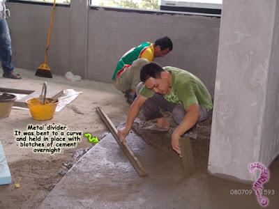

Cracks and Holes
We have considered the possible cracks and holes. We would have a pool table in the lounge and one of our biggest concern was that the occasional miscue would send the ball out of the table, onto the floor and possibly damaging the floor. We thought it was rather smart of our ID to suggest creating sections of flooring that you see with this pix:-
080709%20cement%20screed%20lounge%201593
As the renovation progress, we are pleased to see how the cement screed flooring is turning out. Tom took some pixs and I organized them as an email attachment to the ID, telling him that we are super pleased with how he had arranged the metal strips:-
