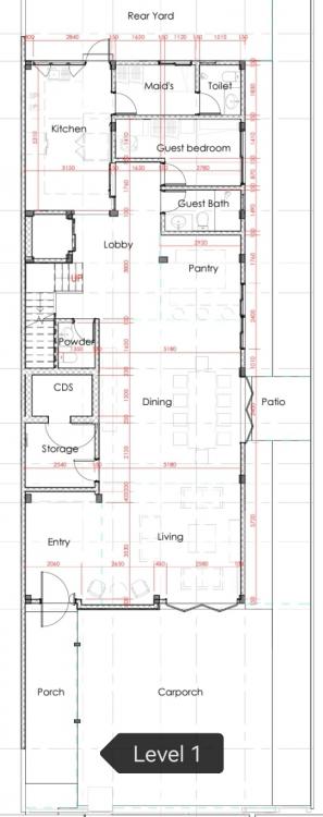

Hi, need some opinions of wifi setup of a landed property consisting of 3 storey + a mezzanine on the ground floor.
L1 - ground floor
L2 - mezzanine
L3 - bedrooms
L4 - attic
After much consideration, I'll be using Netgear Orbi RBK853(1 router, 2 satellites) wifi6 mesh system + a 24-ports PoE switch.
The fiber ONT will likely to be at the DB box on L1 with 2x cat6 UTP cables connecting to the mezzanine platform floor. Pls refer to blue box on photo for an idea where the router will be mounted. This router will serve the ground floor + mezzanine. With 1 satellite each on level 3 n L4.
So the link will be modem@DB - router(blue box on L2) - switch@DB, thus need 2x data point at the router for Ethernet back haul.
The other 2 satellites will be centrally mounted/placed on L3 n L4.
Is the above setup OK? Or should the router be at L3(central level of the house) n the satellites on L1 n L4?
Welcome all comments n advices, thanks.
I was trying to reconcile your floor plan to your photo and couldn't. Realised that you just took the photo off the web and it's not your house.

Sorry, forgot to state that the pic was from the Internet as the house is still under-construction and that's closest pic i could get to illustrate my intention of the router's position.

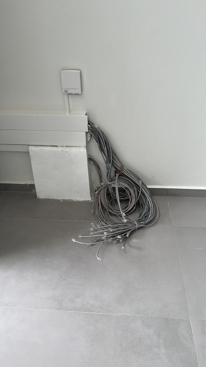

I will be shifting to a landed and I see I have around 50 plus lan / phone lines cable to connect to.

is your photo your existing (old) setup or new setup in your new house? Cos if this is for a newly constructed house, i would be giving the contractor a lot of grief for this type of workmanship.
WIFI setup should actually be planned before construction start since the cables should be laid in optimal locations and doing it after would likely mean you need to pull cables or have more access points to make up for the limited coverage wall lan points may provide. eg: if an AP is mounted on a wall, a whole level could get the WIFI signal from this single AP. but if a AP is placed on a desk next to a wall in a room, you may need another AP on another end of the level to provide coverage for poor/dead spots.
Also, LAN cable termination plays a part in how the network equipment can be placed. With reference to the photo above, the termination is very short, maybe about 1.2m. This means you will either need to mount your data switch on the wall or have a small shelf/desk next to the bunch of cables to do the connections. With longer termination length, there is more option on how/where the network equipment can be placed.
There's 2 sets of cables, data cable for networking/internet and telephone cables for your telephones usage. Nowadays, contractors also use CAT6 cables for telephone cabling so your contractor should have labeled the cable ends properly so you can identify which cable is for what.
For network cables, you need to connect all the cable ends to a data switch. If you have less than 23 network cables, then a 24 port data switch will be enough. But if you have more than 24 network cables, then you need to decide if you want to buy a 48 ports switch or 2 sets of 24 ports switch. Note that a 24 port switch will need a "spare" port for the uplink which is to either connect between switches or connect to a router. So if you have 2 sets of 24 ports switch, you will need to cater for a total of 3 "spare" ports, 1 port on each switch to connect to each other and another port to connect to a router.
TP Link is more of a small home use switch so it will work for your case but personally, I would prefer better brands of which some offer limited lifetime warranty. With limited lifetime warranty, you pay once and if the switch fails 5 years down the road, you get a replacement FOC (may get another model if existing model is no longer available).
To get WIFI coverage, you will need at least one access point for each level. As I mentioned earlier, if you had not planned to have ceiling mounted APs at the start, you may need to buy more APs to provide more coverage. How many APs you need would be more of a trial and error testing now as you need to install an AP first, then use a mobile phone with a WIFI detection app to check the signal strength. If the signal strength is poor/low at certain areas, then you may want to consider adding another AP to provide coverage. At minimum, you would need at least 4 APs, one for each level. your level 2 with 4 bedrooms may require an additional AP if the WIFI signal is bad.
Do note that a wireless AP (Access Point) is not the same as a router. Those equipment bundled by telcos are WIFI routers which have AP functionality built in. But a true AP simply receives and sends the network traffic to and from the router without doing any routing. While you can buy multiple WIFI routers to serve the same function, it would be best if you can configure these WIFI routers without the routing function so that they act just like an AP. Else if you have too many equipment performing the routing function, you may encounter performance issues and it's not easy to troubleshoot as well. As a general rule, one local network should have only one router.
Now for the telephone cables. DO NOT connect your telephone cables to the data switches as they don't serve the same purpose. But you could technically convert the telephone point to become a data point if the correct ports/plugs are installed. By right each telephone cable can only be used for 1 telephone line. Meaning if you have 5 telephone cables, you will need 5 telephone lines to call out. However, you can use telephone line splitters to combine these lines and make do with one single outgoing telephone line. Another option is for you to install a PBX system at home. With a PBX, all telephone lines from the rooms will connect to the PBX. The PBX will then be connected to the main outgoing telephone line. With a PBX, you can also get the intercom, hold, call transfer functions etc. So it's basically like a office telephone system but installed at home. A small PBX system may cost a few hundred dollars so it's not that expensive to have one at home.

The photo is my new house. The way it's left there it's telling me, I must do carpentry there to just hide everything.
Thanks for also feeling my grief, I tell myself to just be happy that my rebuilding was completed eventually without the contractor going bankrupted.
Wifi setup wasn't planned during my consultation but they allowed me to add lan points for cctv, and points for each zone, rooms.
I also just found out that the lift also can be connected to a phone line.
I did not plan for using AP as I've thought that using mesh networks would be sufficient (and really never thought I had the need). My Malaysian colleagues have big landed houses and they do not require such complicated setup at home. They were also shocked to see my cables and told me to build a server room (🙄
I will have to mount the data switch on the wall or have a small shelf/desk next to the bunch of cables to do the connections since I will be doing carpentry work. (My carpenter is very good so he will help me settle it once I get all my devices in)
I bought a Panasonic phone system (kx-tg7731) with 6 phones to serve as intercom for each room but have not wired them up.
What would be the brands of the AP or switch that you will be recommending as I'm not familiar with that. I choose TP Link as the nodes seems most reliable compared to the many brands that have failed me in the past.
I think I do not have to hook up all 50 lan points too so I guess at 24 port switch should do the job now and I can expand it further next time too right?

If the type of workmanship was for my house, I would have given a piece of my mind to the QP and contactor and ask if this is acceptable for their own house. I do not know what that big chunk of white "box" coming out from the floor is but for a brand new rebuilt house, there shouldn't be this type of funny things jutting out at wierd locations. Even if there's no choice but to have something to come out of the floor, at least something can be done to make it more aesthetically pleasing rather than leave it like this.
By right all networking items should be part of the initial design of the house together with electrical wiring. There's requirements from IMDA on where the network points need to be installed and so on. The phone line in the lift is needed for safety reasons. Imaging if one is using the lift breaks down when no one else is at home. By right the lift should be self-homing and goes down to the first floor and automatically open the doors if there's a problem. But there's always a chance things don't work when they should and hence the phone is needed to allow the passenger to call for help.
Not sure how big your colleagues landed houses across the causeway are. But in SG, everything is maximised in the plot of land and the walls causes the WIFI signal to degrade. With mesh setup, the mesh nodes will require line of sight to work well but with walls in between, mesh doesn't work well. So one will still require mesh nodes or AP with wired backhaul to get the best WIFI signal. When I did my house, I had already planned for all my network and AP locations. I have a server rack in a designated location to house all my network equipment as well so that things will be tidy. The server rack which I bought 2nd hand cost me less than $500 which would be cheaper than having custom furniture built.
The phone system you bought is not really a full fledged phone system. I guess you could daisy chain the telephone cables at the termination point such that the base units are all connected to the main incoming line. The PBX I'm using is a Panasonic KX-TES824 which I placed in my server rack. The digital phone line from my ISP's ONR is then connected to the PBX as the incoming line.
For network equipment, I prefer HP Enterprise models as they usually come with limited lifetime warranty and some models don't burn a hole in my pocket. Of cos if you're the type who wants to upgrade often to get the latest technology then the lifetime warranty don't matter much.
I would suggest you just plug in all the network points at the start and save your headache in future. From your photo, it doesn't look like your contractor had labeled the cables as well so you will not know which cable is for which point in your house unless you spend time to trace them. If your CCTV recorder comes with network points with POE, you may want to connect the CCTV network cables to the recorder directly rather than to the switch. Unless you require the use of POE devices on your network, you can get a normal gigabit switch which will be slightly cheaper than a POE switch. Alternatively is to buy 1 normal and 1 POE switch such that your POE devices can be connected to the POE switch and other devices connected to the normal switch.
