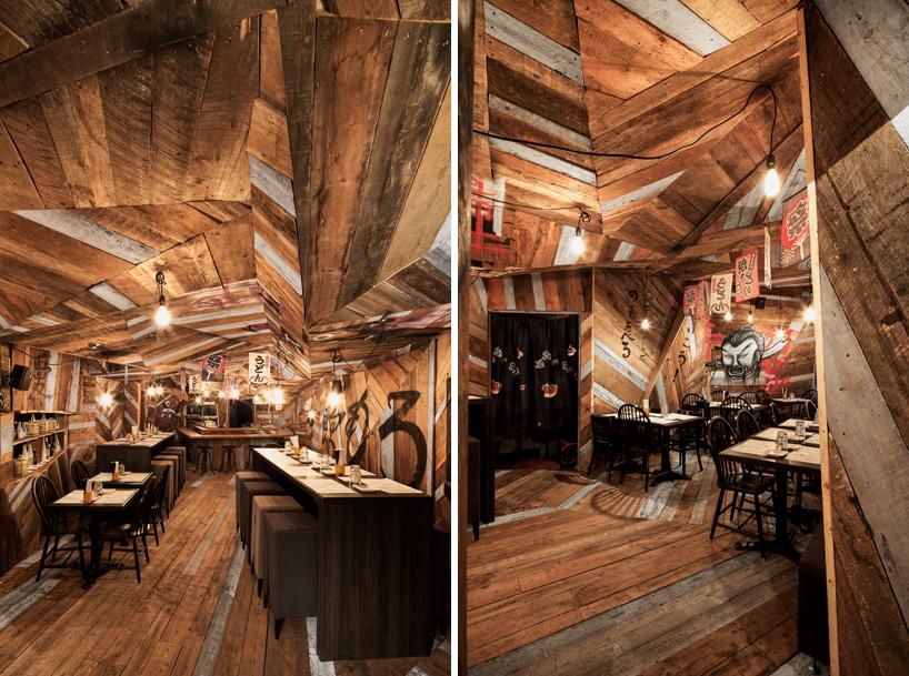

Anyone tried before this anti-termite treatment for wood? I think wood flooring has its benefits - more warmth, and creates a homely cosy feel. I personally like timber flooring especially those rustic looking, worn out kind of wood that gives the space a sense of history and an aged look. If done nicely, it really adds personality to the space.
But wood is a natural material so the number #1 priority is to treat it properly before installation. Anti-termite protection is a must since we're living in a tropical climate native to subterranean termites which one of the most destructive pests around if you have a lot of wood furniture and finishings.
